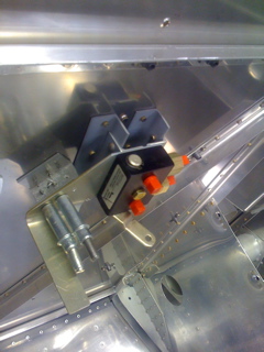

It's pretty easy to roll your own bracket for mounting. I made mine
from 3/4" angle and Nick Gautier gave me a duplicate of his plate
design that you see between the bracket and valve in the picture
attached that will hold the adel clamp for the vernier cable and
forms the stop for the arm on the valve. The valve, straight
fittings and other odds and ends shouldn't reach $200.00... and you
can get it all from Spruce.
