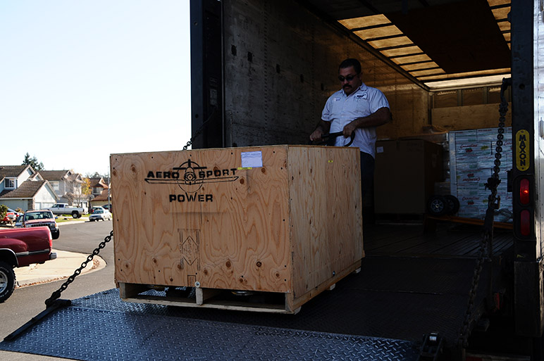

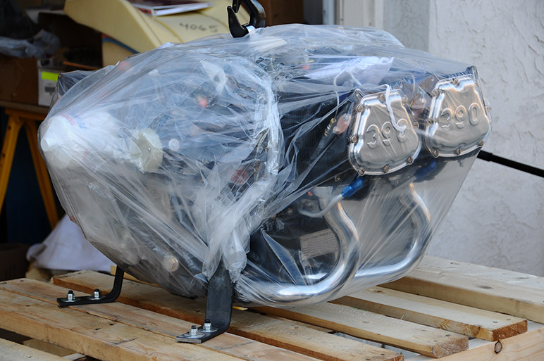

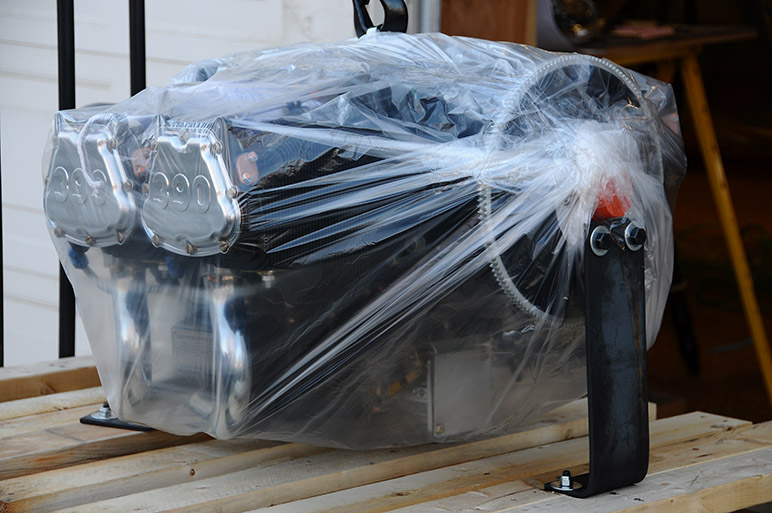

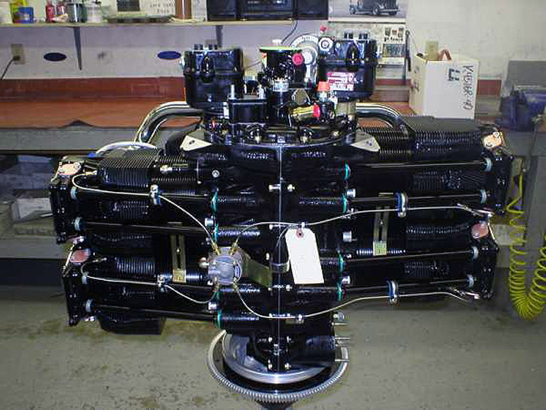

I can't offer any performance or reliability input at this point, but I can say that the customer service and quality of assembly from Aero Sport Power is excellent ( http://www.aerosportpower.com/ ). They delivered on time and as promised and the IO-390 they built is a work of art. I went with gloss black and chrome and she is a beauty!
Sue and Bart at ASP were great and emailed me photos of the build and break in processes along the way. The engine arrived in perfect condition in a very well constructed, plywood box. The 3-year warrantee from the first flight is also hard to beat.
Here is a link to all of the pictures I received from ASP and also some I took of the delivery:
http://www.mykitlog.com/users/category.php?user=dralle&project=638&category=2972
I also opted for an additional 10 hours of break in to get me past those initial, critical break in hours. The log book shows 11.5 hours of total run time. Also the peace of mind knowing that the engine is running great for that amount of time is comforting. The extra $1k was well worth the investment in my opinion. I won't have to sweat some extended taxi testing now...
Anyway, give Bart or Sue a call at ASP and talk to them about what they can build for you. Great people; great service; great product. http://www.aerosportpower.com/
