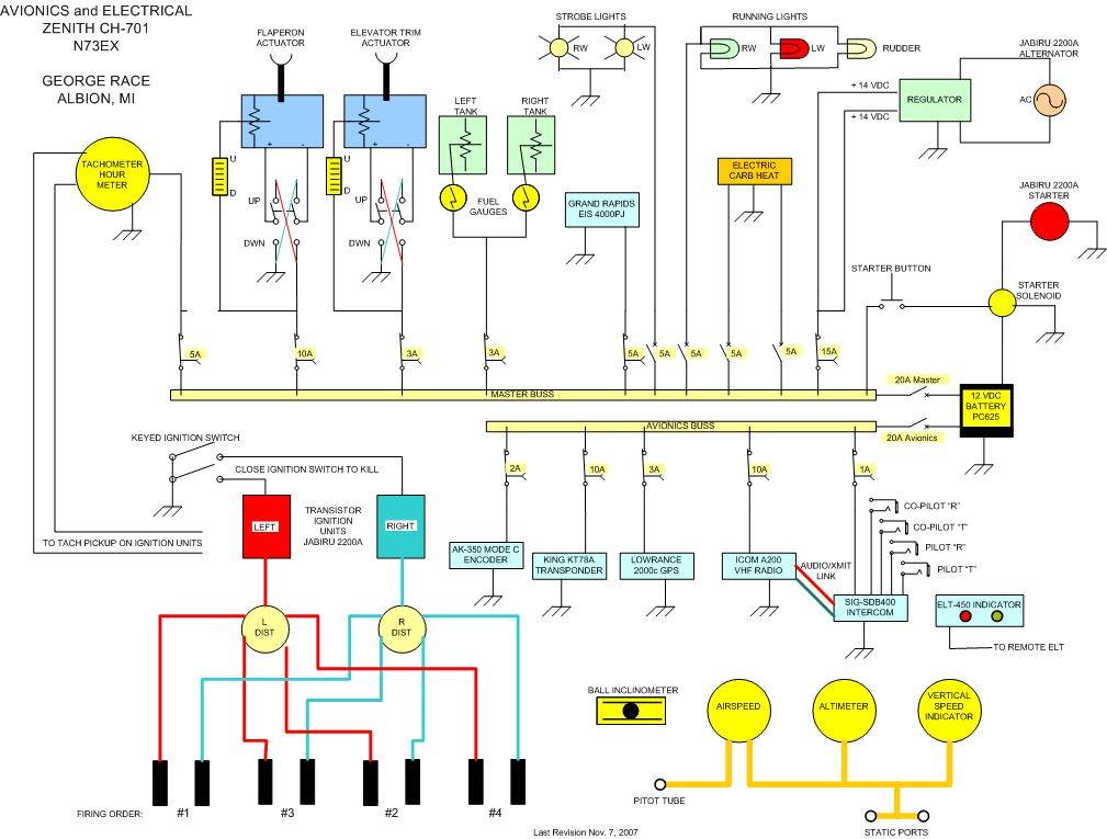

6) Also, is there any free simple software out there for drawing up
a schematic. My pencil actually works pretty good and there is no
chance of losing the file unless my black lab decides my book is a chew toy!
If someone would like to share what they did for a schematic I can
use fro an example it would be great!

Attached is the schematic diagram of what I did building a CH-701
It is in picture format. I have it in DWG and DXF if it would be of any help.
Diagram was drawn using Microsoft Visio.
George

PostPosted: Thu Feb 26, 2009 5:34 am    Post subject: Fuses /Breakers and a few electrical questions Reply with quote
George,
Excellent picture. Excellent design.
Ken Arnold
Flying CH701 N701LK
