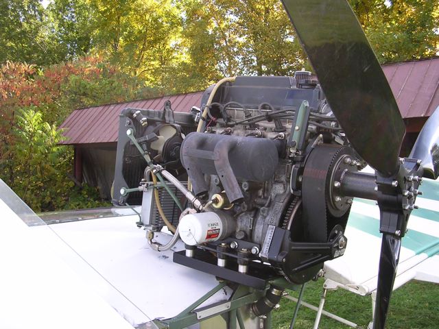

I apologize for not scaling that pic down. My mail even kicked it back.
The support tubing is fastened to the engine so they shake in
unison. Reasoning is so that
the hose nipples won't fatigue as early. The whole works is now
behind a fairing.
The oil cooler, hoses and integral filter mount/thermostat are from
Summit.
BB
