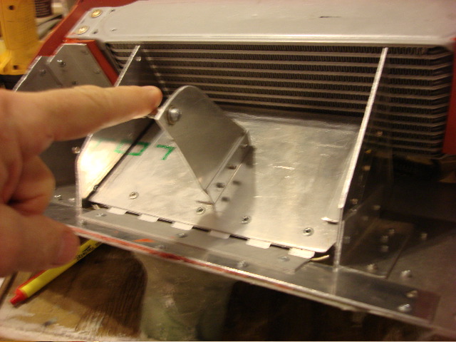

Does anybody have any wisdom, ideas or pictures regarding what they did in terms of heating their cabins? I would think it would be more comfortable to heat each footwell; Has anybody fabricated a nifty plenum device to accomplish the task?

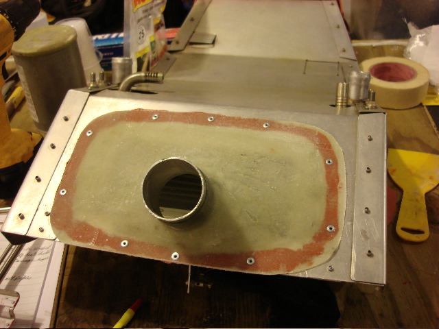

I can help you on this one. Here are a few pictures that explain it
all. The bottom line is you can go to Bud Yearly's sight
www.customflightcreations.com and download this on a PDF document.
Thats what I did then just made a few modifications to it. I ran the
heat from this plenum into the cabin with 2" to a box then 3 - 1" hoses
to the port, starboard, foot-wells and one to the windscreen for
defrosting. Hope these help.
Jeff R.
