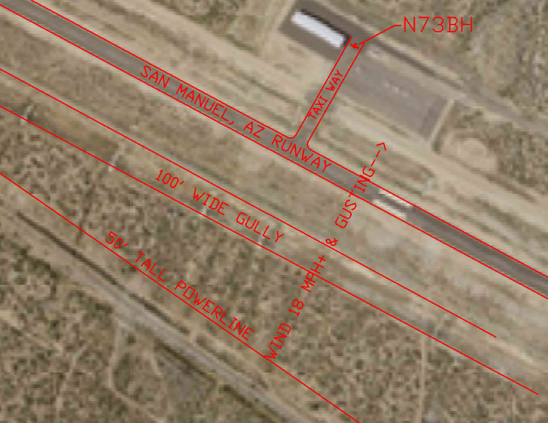

Cactus was great this year. Friday was a bit sparse as many people could not travel until Saturday. It is allot more laid back than Copperstate and a high ratio of old farts (like me) and old airplanes. They had a social hour each evening and it seems that just 3 or 4 of us were drinking the free beer Friday night but many more were there for Saturday night. My Trip from El Paso averaged 15-20 mph headwinds (at) 6500. Higher would have been much worse. I had to land at San Manuel, AZ for a pit stop. That's when I found I had a flat.
After 2 hours of screwing around with my flat and help from a couple really nice strangers, the winds had come up to 18 mph + gusts directly across the runway. I had to make a takeoff on the taxiway. After taking off I had to climb in a downdraft to 6000 ft then head through a pass where my ground speed was 39 and indicated airspeed was 85 mph. 5 hours total flying time. Going home Sunday a friend and I flew together over to Marana Rgnl. for breakfast. They have a great restaurant there. Tailwinds going home averaged +/-10mph but it was a rough ride all the way since we got a late start.
Here is a picture of San Manuel taxiway.
[img]cid:001701c9a192$5ad9a540$6400a8c0(at)DUDEII[/img]
