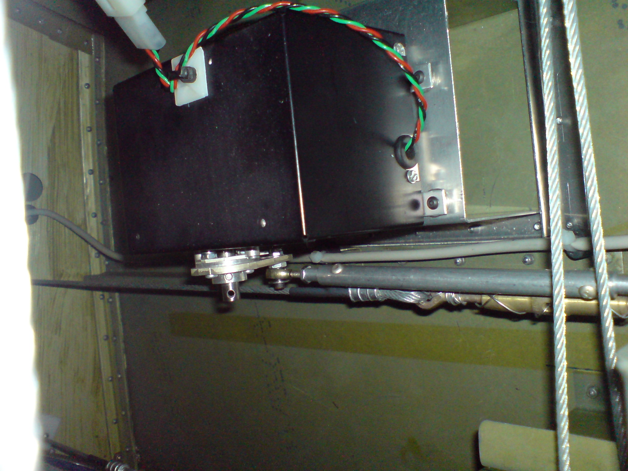

Can any one give me a picture or a drawing on were the AP servos are mounted on a XL?
Trying to plan ahead for the fusalage etc.

I can't speak to the kit planes, but on my AMD, the elevator servo is
mounted to the underside of the baggage shelf right above the middle of the
trap door, and the aileron servo is mounted at the end of the control rod
behind the pilot's seat (with dual sticks).

Look in the photo archives of the original "zenith" Matronics list. I
collected a number of photos of builders' AP servo installations and
uploaded them on Feb 11th, 2006. Also there was a recent discussion on the
zenith.aero list. Steve Smith posted a picture of his pitch servo installed
on the firewall and linked to the stick.
http://www.matronics.com/photoshare/zenith-list.html#Top
-- Craig

have a look
drawing (i have a different servo) and fitments in my xl
