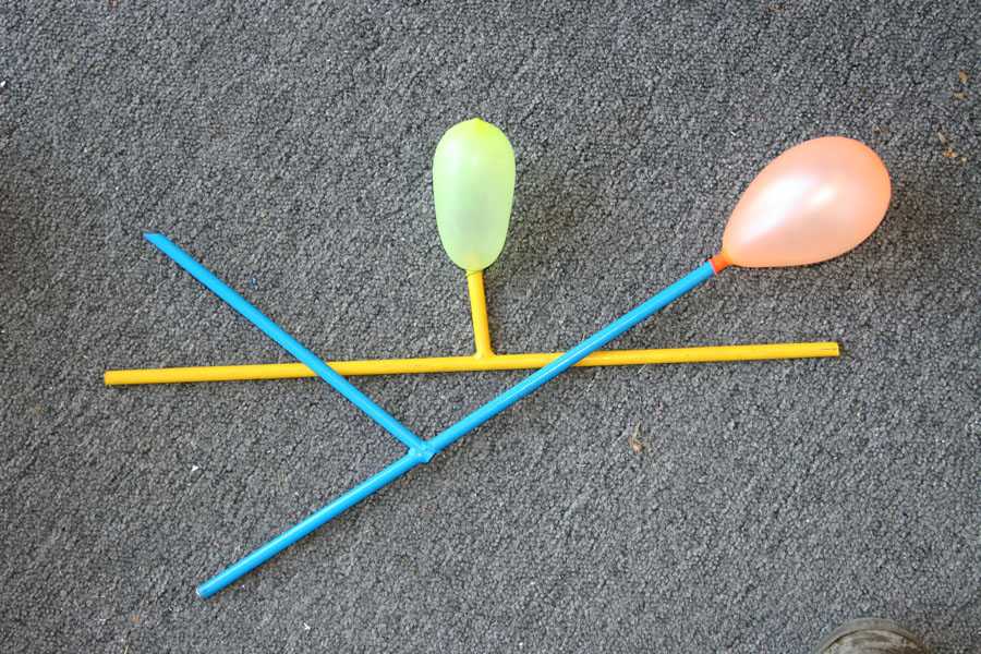

I did the deed. To illustrate the discontinuity of the tubing in the
Kitfox, I took two sections I cut out of a couple of projects and attached
filled balloons to the ends of the tubes. The yellow tubing came from an
elevator cut to fit a trim tab. The blue tubing came from the hat rack area
where that tubing was cut out to in an attempt to
improve the shoulder harness attachment points.
In the yellow tubing section, the long tube is the trailing edge with the
tube rib the closed end tube. In the blue tubing section, what appears to
be the long section is actually two tubes butted to the short piece which is
continuous.
Lowell
 Filesize:  99.62 KB
 Viewed:  9058 Time(s)

For what it's worth, when I removed my horizontal stab supports (so I
could weld on the larger 1/4" rod ends) and cut one end off, I could
smell the line oil (tube seal) inside the tubing.

Looking at the big blob of beading on the plue piece it doesn't surprise me
that it is closed off inside the weld. The yellow one is a lot harder to
tell and I'm actually surprised that it is just but welded without first
being cut out and shaped.

PostPosted: Tue Apr 28, 2009 5:40 pm    Post subject: Corrosion Prevention Kitfox welded tube joints Reply with quote
Usually I give up by now, but here goes. Noel, lets say you are fabricating
a fuselage on a jig. First the longerons on one side, top and bottom, are
clamped into the jig. then the vertical stringers and angle supports are
trimmed, as you discribe, to mate with each other without overlapping
anywhere in a nice tidy cluster. What treatement do you give the longeron
to ensure internal continuity. Do you notch it as you did the stringers or
do you drill a hole at the center of the cluster?
As you all recall, this thread started with advice on introducing a sealant
into the Kitfox tube interiors as a corrosion preventive.
With regard to the first paragraph, Kitfox did notch the tubing to get a
close joint, but they did not drill or otherwise provide for continuity
throughout the tubing interiors. And my opinion is this. I would not fly
in an airplane that would have the number of holes drilled that would be
necessary to protect every tube interior throughout the airplane, especially
if the holes were drilled by an amateur builder.
Lowell
