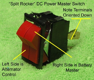

Hence the development of the infamous "split-
rocker" master switch for single engine light
aircraft.
[img]cid:.0[/img]
This product's rockers were mechanically interlocked
to prevent an alternator from being on line
without a battery . . . yet allows the battery
to be on without the alternator.
