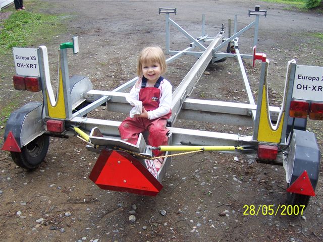

Solution: in Finnish Road Traffic Law there is a group they call like "moveable devices".
I just named my trailer to be a moveable device!
That means no oblication to register and no insurances and I am free to make any modifications.
So, my trailer is now an experimental trailer and I have added for example second axle and so on.
Conditions:
1) a red triangle must be fixed to the trailer back instead of register plate.
2) all the cargo must be removable only by tools (I have to use a set of spanner tools to take Europa away)
4) speed limit 40 km/h (nobody cares, I prefer 60 or 70 km/h is max)
Look next time those huge trailerable traffic signs what they use in road work there.
I assume they are not registered also in Netherland. They are moveable devices then.
They trailer also giant boats from harbour to harbour by unregistered trailers (=moveable device then).
One extra advantage: my trailerīs MTOW (maximum trail off weight!) loaded with Europa is more than 750 kgs.
My poor trailer is brakeless and normally brakes are necessary then but because itīs moveable device, no matter and nobody cares.
I was once in a traffic stop check and policeman asked "what the hell is that?"
I just answered "cannot you see - it is a flying trailer!" and so he was happy and I was free to head to airport.
After this pic (attachment) I have add several extras like floor. Itīs empty weight is around 500 kgs now.
I hope this helps - let me know.
