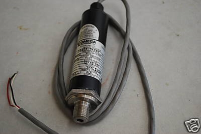

transducers these days are usually amplified
piezo-resistive device like . . .
[img]cid:7.1.0.9.0.20090611090552.01d28c30(at)aeroelectric.com.0[/img]
These can be pretty pricey compared to the automotive
devices that behave pretty much like a rheostat.
