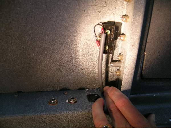

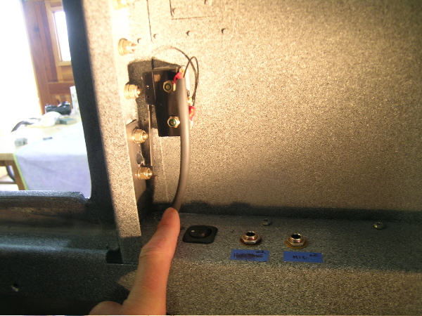

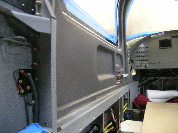

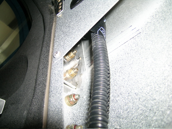

Here are a couple of pics of doing it differently on the door open indicators. First notice the different type of switch switch. No magnets. I put these switches in the rear for the rear pin as those are the ones most unlikely to engage. Also C note the depth that my pins go in and I also put an additional 1/8 piece of aluminum backing to the fuselage bulkhead C it is tied in with the plastic pin aligning blocks. Lastly C I left the threaded bolt inserts in my hollow rods for strenth. Their depth goes beyond the plastic block that is attached to the (door).
JOhn G
