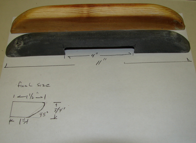

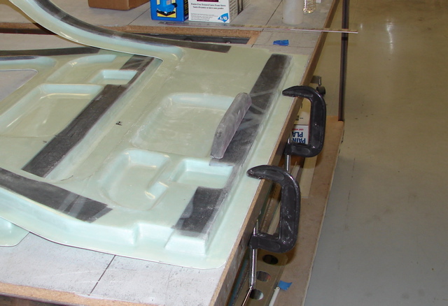

I'm still messing with various door mods, one of which is a molded in armrest that acts as a handle to assist in the closing process. The handle is in the center of the door, which hopefully will apply even pressure on the fore/aft seals. Enclosed is a picture of the handle, not yet glassed onto the door.
