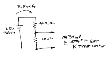

Assuming that you're interested in doing a
gross functionality test at 34mV, then you can
craft this little test rig.
[img]cid:7.1.0.9.0.20090622095230.01220538(at)aeroelectric.com.0[/img]
A couple of easily acquired resistors from
Radio Shack and a AA battery holder.
http://www.radioshack.com/product/index.jsp?productId 62247
http://www.radioshack.com/product/index.jsp?productId 62338
http://www.radioshack.com/product/index.jsp?productId 994588
wired as shown will get you a voltage in the
right ball park. If all the errors are accounted
for, your instrument will read 1504F, but if it's
off by as much as 50 degrees, I wouldn't worry
about it.
