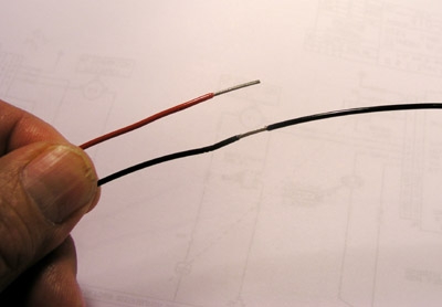

At 09:03 AM 6/28/2009, you wrote:
No - I saw that one and it's for shields. I was looking for something similar for single conductor wire.
It's no big deal. I was just looking for one of Bob's elegant soultions.
Sorry for the long delay in responding . . . I
wish there were an "elegant" solution. Obviously
the D-Sub pin is limited to the insertion of but
a single 20AWG wire. The task is to tap
into a few conductors in a manner that does not
result in the wire bundle taking on that
"rabbit satisfied snake" appearance.
The lowest volume approach I can deduce is
to bare a short segment (1/4 to 3/8 inch)
of strands on wire to be tapped a couple
of inches from the end . . .
[img]cid:.0[/img]

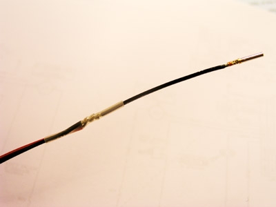

Wrap the branch strands around the open gap, solder
and heat shrink. Then install the d-sub pin.
[img]cid:.1[/img]
You probably want to have the spice occur outside
the back-shell of the connector. Stagger their
positions so that they don't "bulk up" a lump
in one place on the harness.
[img]cid:.0[/img]
[img]cid:.1[/img]
  Are you committed to 20AWG wire throughout?
  22AWG does this hat-dance a little better.
