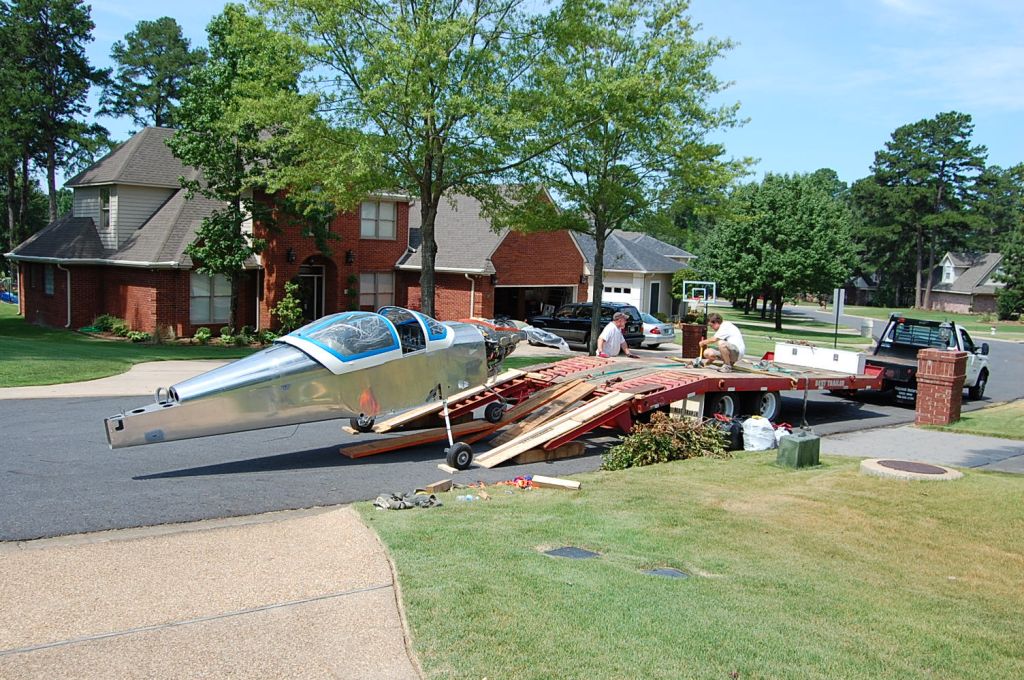

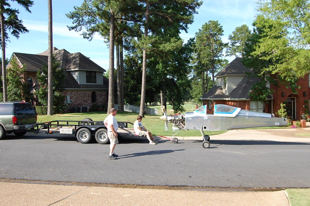

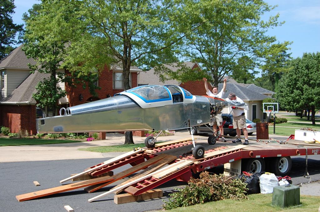

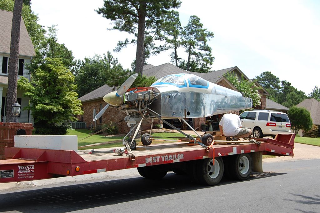

For those wondering how to move an airplane from the house to the airport,…. Here is a visual. Note that the picture with the black trailer is how someone looks who just realizes that a car hauler is NOT wide enough. If it has fenders,…. It isn't wide enough ;-(
An hour later, we had moved up to a 30,000 lb dozer trailer (CDL required) which turned out to be perfect! The ramp angle kept the tail high, 8ft + wide bed was just right. With just the gear and the engine mounts tied down, it moved around some which was good but didn't move forward or back. It takes a pretty good assortment of heavy tie downs but it really wasn't as much of a problem as I thought it would be. 45 mph on the freeway was easy, the problem was with the side roads which were pretty rough with a heavy trailer and no load. A 20 mile trip in about 40 minutes. Took 5 minutes to set the ramps and back it off.
Good Bogy-Bar is a requirement!
If's funny, I was a nervous Nellie but my buddy's who did the majority of the loading were just fearless. As Allen said, " who cares, it's not my airplane". (arms raised Wink Apparently that takes all the stress off Smile
Bill S
7a getting closer to the runway
