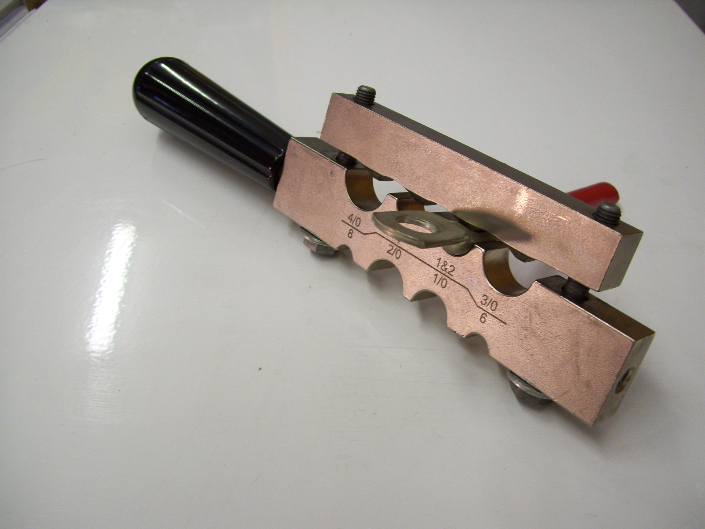

PostPosted: Sun Aug 09, 2009 8:57 am    Post subject: Crimpers Reply with quote
Here is a crimper sold by Plane Innovations LLC for $96.00. Call them at
(435) 826-4662
Paul Bowmar
N67KB RV-4
