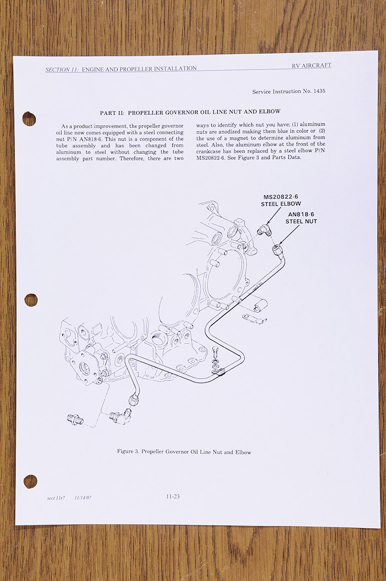

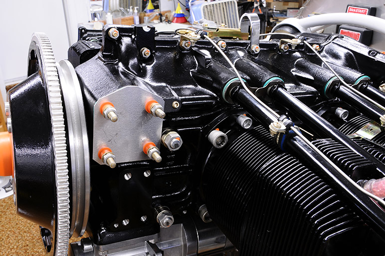

Van's includes a document called "Service Instruction No. 1435" describing a long, aluminimum tube that connects from the front of the engine to the rear where the prop governor is attached (see attached photo).
Since the prop governor on the IO-390 is mounted up front, is there even such a tube for this application? If so, what's the part number and where's a good place to get one?
Thanks!
attached photo).
No. With the front-mounted governor, all the oil passages are
internal to the engine.
Kevin Horton
