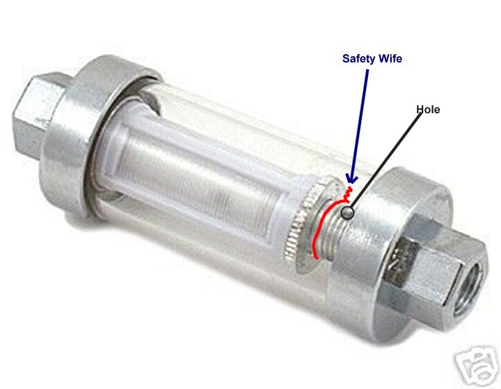

What I saw in the picture was the knurled nut used to to tighten the filter element against the shoulder on the center stud which appears to be round. The cheap chicom units just tighten the ends on to the cast center piece which twists the filter when tightening.
Rick Girard

PostPosted: Fri Aug 28, 2009 3:25 pm    Post subject: Clearview fuel filters on eBay Reply with quote
At 10:33 PM 8/27/2009, you wrote:
These appear to be the real deal, although I haven't bought one to
make sure. $12.95 includes 3 extra filters and gaskets and free
shipping. Worth a look if you're in need of a fuel filter.
If you use these, it's best to safety wire the inside
tube to keep the round "nut" from vibrating loose,
backing out and covering the inlet hole to the right.
There was an advisory out years ago & I've seen it happen.
There are also cheap imitations out there that look
just like the good ones.
I still use this kind of filter, as long as the "O-rings" are
fresh & you don't crank it down, it seems to work fine.

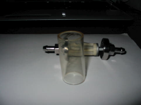

PostPosted: Sun Aug 30, 2009 6:29 am    Post subject: Re: Clearview fuel filters on eBay Reply with quote
My filter with the warped plastic tube.

aslsa.rng(at)gmail.com
PostPosted: Sun Aug 30, 2009 6:49 am    Post subject: Clearview fuel filters on eBay Reply with quote
Please turn your flash on. I can't make out anything, the picture is so dark.
Rick Girard

PostPosted: Sun Aug 30, 2009 7:04 am    Post subject: Clearview fuel filters on eBay Reply with quote
Kirk S/Gang:
If it was mine, I'd replace the plastic tube with a piece of 6061 tubing, if
the rest of the filter looks like it will be serviceable and reliable.

Rick it looks good here . Does it show ok to anyone besides me? John, I did that per your suggestion and it appeers to be working ok.
PostPosted: Sun Aug 30, 2009 7:39 am    Post subject: Clearview fuel filters on eBay Reply with quote
Kirk S/Gang:
I am very careful not to overtighten the caps. On one occassion I did.
Result was the end of the tube pulled past a round O ring causing a leak.
Some replacement element kits come with square cut and some round O rings.
Usually the square cut is less Murphy proof. However, the round O ring
seals work fine as long as I do not over tighten.
I think the aluminum tube works best with square cut ends, rather than
sanding and rounding. I polish the tube on a buffing wheel once in a blue
moon, but am careful not to hit the square edges of each end to prevent
rounding them off.
My filter uses a circular thumb nut to secure the nylon element. I snug
this up tight by hand. I have never used safety wire on it and never had a
problem of this nut loosening up.
Takes a couple minutes to inspect the filter by removal and disassembly, and
the aluminum tube gives me the satisfaction it ain't gonna break in flight.

PostPosted: Sun Aug 30, 2009 7:41 am    Post subject: Clearview fuel filters on eBay Reply with quote
Tried it with WMV and Irfanview, both showed up near black.
Rick
