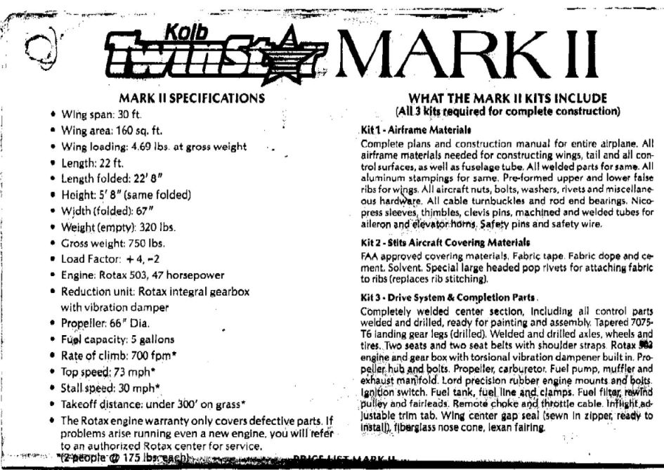

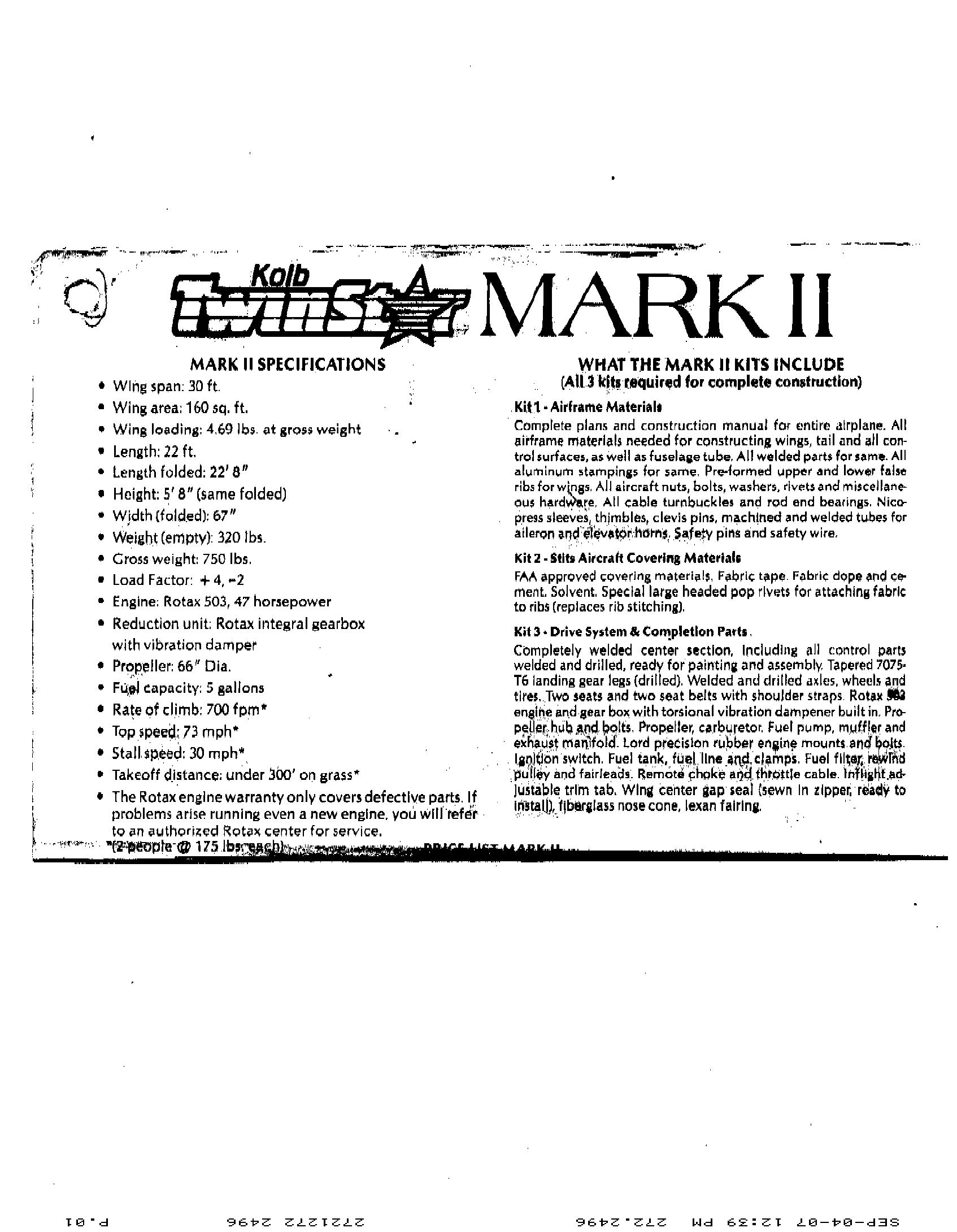

When I first purchased my Mark II I believe I got the attached document from Dennis at Kolb.
Congratulations on your new plane. You'll love it.
Mark II Specs.tif
Looks like the .tif file didn't work. Here is the same file as .jpg.

Cristal, The tiff file came through fine here. I did the same and cropped it a bit.
