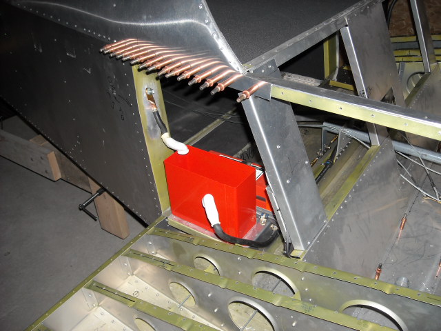

Anyone with a 601HD, Cont O-200 with Sensenitch metal prop. Where have you placed your battery? I have the 8 gal header tank and wing locker tanks. Can't do a honest W&B yet.

I have an HDS with the same fuel setup, Corvair and WarpDrive. Location per Corvair instructions.
Try behind the passenger seat and see what you get. You should come close, might have to go aft a bit farther. Picture attached.
