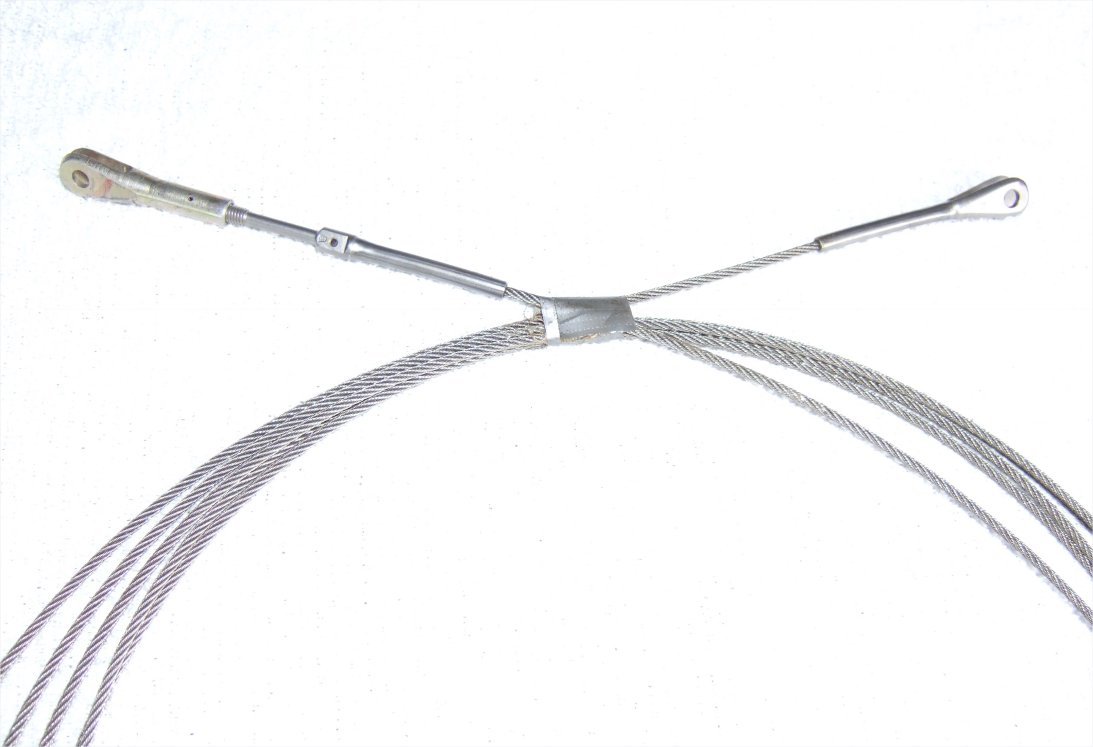

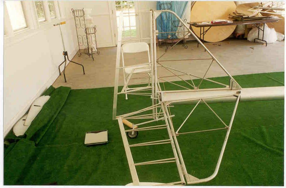

I had all my cables swaged this way ( elevator, rudder and tail wires)
by a guy near Aircraft Spruce in Griffin Ga.
He supplies the cables and fittings.
done with a rotary swaging tool
Did not cost as much as you think and looks real clean.
He does need to know the length from "hole to hole" on the attachment
points and they are only adjustable about an inch before you'll have to
start twisting the cables again. There is only a turnbuckle "pressed on" on one end.
I'm sure there are people like him all over the country.

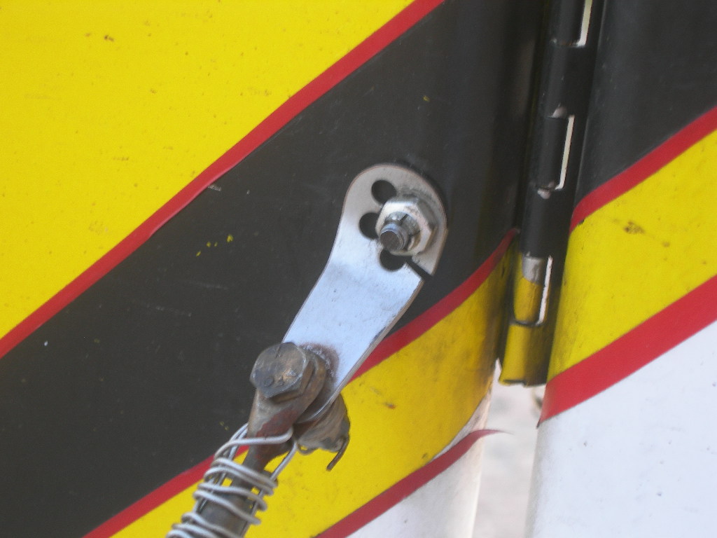

No multi hole tangs, either. Those things went out with the standard Rogallo in '76. Make your cables per the Kolb plans and you'll be just fine. Extra cables are extra weight, not extra safety.
Rick Girard
Rick,
My cables were made per Kolb plans, and they came with multi hole tangs. You contradict yourself... Your claim about extra cables no providing extra safety is just plain wrong and dangerous advice. Almost every airplane in the world that uses wire braced tails uses two sets of wires, there is a good reason for this. Given Jimmy Youngs recent picture, I am surprised to see a statement like yours from anyone. Had that tang let go, an extra set of tail bracing wires would have prevented a crash and almost certain death.
You recently very wrongly posted that we could not tell if properly designed wingtips would improve the flying characteristics of a Kolb, and that it is not worth doing. Now you post advice that is downright dangerous and false. If people do not want to improve the safety of their Kolbs by adding an extra set of tail wires, that is their choice. But you should not be making dangerous and materially false statements that will prevent people that want to make their make their Kolbs as safe as possible from doing so. You recently complained about my posts not being " Nice " while you post false information here that could get someone killed...
Given the picture below, and many documented cases of tang, swage, and wire failures in aviation history, Possums extra set of tail wires are a great idea, and a great safety improvement to his Kolb at a very minimal weight.
Mike

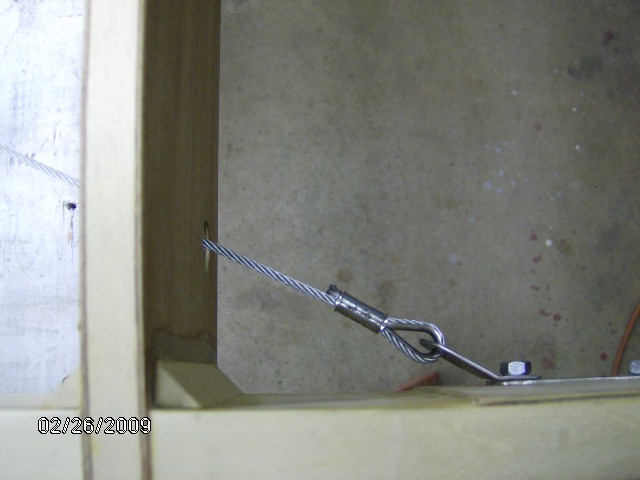

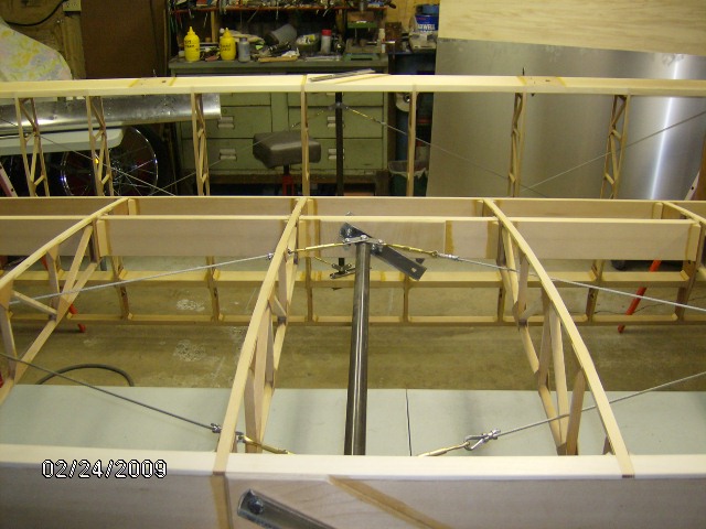

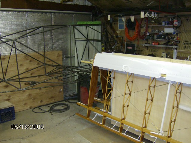

PostPosted: Thu Sep 03, 2009 8:59 am    Post subject: Re: turnbuckles and aircraft hardware Reply with quote
The Turnbarrels I bought weren't for my Kolb, They were for the
cross bracing cables in the Wings of my Wittman Buttercup
Attached to the Compression strut in the Middle and crossing to the
root end and to the wing tips...
My cables on my Kolb are Swagged...
Only turnbuckles are on my Rudder cables and Elevator...
Gotta Fly...
Mike & "Jaz" in MN
Kolb list- http://groups.yahoo.com/group/kolbaircraft/
PS the reason the "tang" let loose... Has to be from over tightening the
turnbarrel.... If it's done to print... your not gonna get it THAT tight...
Sometimes... people only THINK they are improving something...

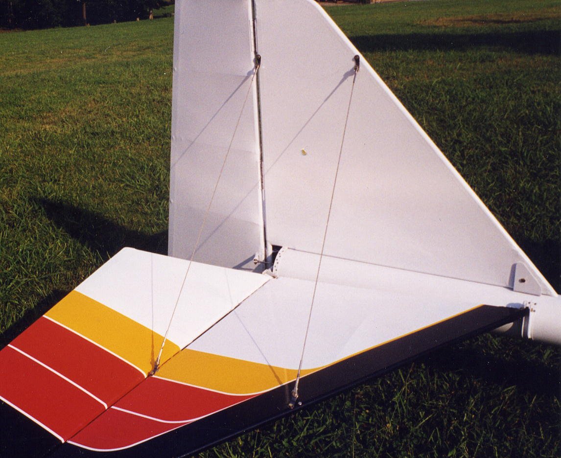

At 06:45 PM 9/3/2009, you wrote:
Mike,
You really need to take a course in "How to disagree with someone".Your usual openers,Only a moron,or only an idiot,keep you from being the most regarded person on the list.Personally attacking the intelligence,intentions,or opinions of others is another one.You'll never build yourself up by tearing everyone else down.Just a thought,no offense.....
G.Aman
--> Kolb-List message posted by: "JetPilot" <orcabonita(at)hotmail.com (orcabonita(at)hotmail.com) >
this.
Yeah - you "moron's and idiots" would need to build the tail different from the start
to have the two sets of tail wires anyway.
It's really not something you could go back & change. Gotta have the "sleeves" inside the
tubes where the bolts go thru (that are attached to the tangs) before you rivet the ribs, etc.
Anyway, I was just suggesting a different way to build the wires on the tail, not so much the tail
itself. It's pretty much standard aircraft stuff. I think the 8 tail wires cost about $25 each.
Not cheap, but affordable & nice and clean. You couldn't break them in a Kolb ......or a Pitts.

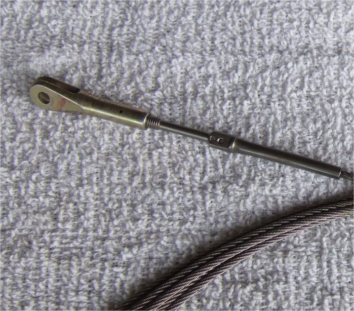

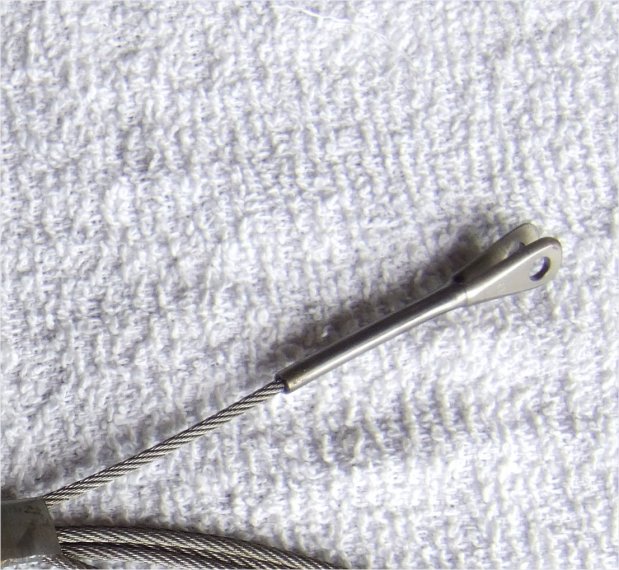

PostPosted: Sun Sep 13, 2009 2:13 pm    Post subject: turnbuckles and aircraft hardware Reply with quote
>Possums,
>Could you please take
>a close up pic of the cable ends on both the fork and turnbuckle sides and
>post it?
>Thanks -
>Jimmy Young
>FS II, HKS 700

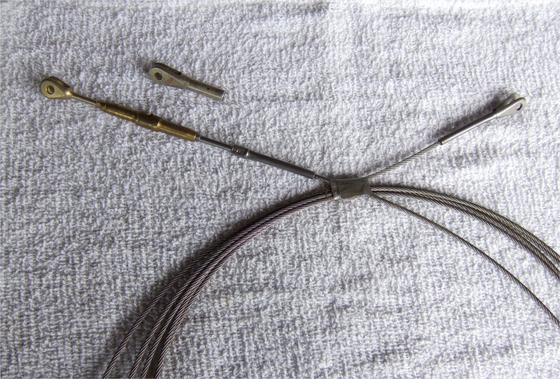

I just use 1/2 turnbuckle on the tail wires, whole turnbuckle
on the elevator or rudder (if you want) or 1/2 on each end if
you want - they will make them for you. Got to give
them the measurements "hole to hole". And it's
nice an clean. Aircraftspruce isn't the cheapest, lot's of
aircraft fabricators have a swaging machine.
The pictures are a little big - sorry , but I assume you want
to inspect them close up?
http://www.aircraftspruce.com/pdf/2010Individual/Cat10137.pdf
