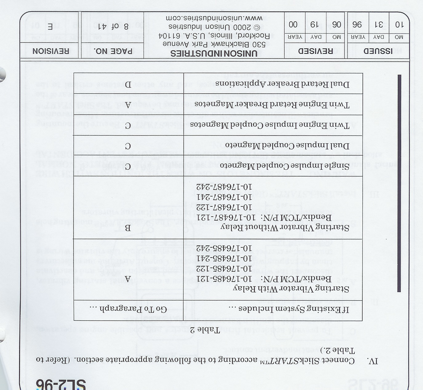

Dave, I know this will end up with a pretty simple install but I can't
get through the installation directions in SL2-96 which is all that came
with the unit. Table 2 on page 7 of 39 has a table that I'm having
trouble getting past. I can't figure out which one applies... and one
option (that probably doesn't apply) shows a jumper that's required on
the starter switch.
I'm going to get my head wrapped around this at some point but sure
would like to cheat first...

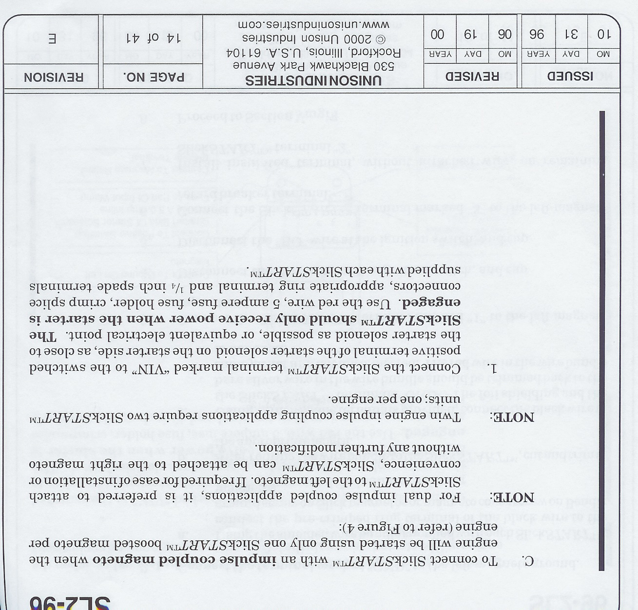

PostPosted: Sat Sep 12, 2009 5:42 pm    Post subject: Wiring diagram for Slick Start with 2 Slick Mags Reply with quote
Dave Saylor is correct. Power for the slickstart comes from the cold side of
the starter relay. It only has power when the starter is cranking. All other
wiring is between slickstart terminals and the magneto including ground. I
will be at the hangar tomorrow and look for the instructions. I initially
wired mine incorrectly and it would not start.

PostPosted: Sat Sep 12, 2009 8:14 pm    Post subject: Wiring diagram for Slick Start with 2 Slick Mags Reply with quote
Bill,
Table 2 sucks.  They make it sound like those are all the possible combinations, but my setup, for example, isn't listed in Table 2.  I have zero impulse couplings, zero start vibrators, one regular mag, and one retard mag.  I wired mine like Figure 3 on page 12 of this version:
[url=http://b2b.unisonindustries.com/pdf/marketing_literature/SL2-96(E).pdf]b2b.unisonindustries.com/pdf/marketing_literature/SL2-96(E).pdf[/url]
I couldn't find anything that talks about a jumper, but if you point it out I might be able to help clarify that. I suspect that they want it to ground the other mag during start.
There's another pub from Unison that says not to connect the same SlickStart to both mags.  I guess they found a possible failure that can ground both mags at the same time, or at least they're guarding against the possibility.  Good insurance, and mine starts fine on one mag.
Dave

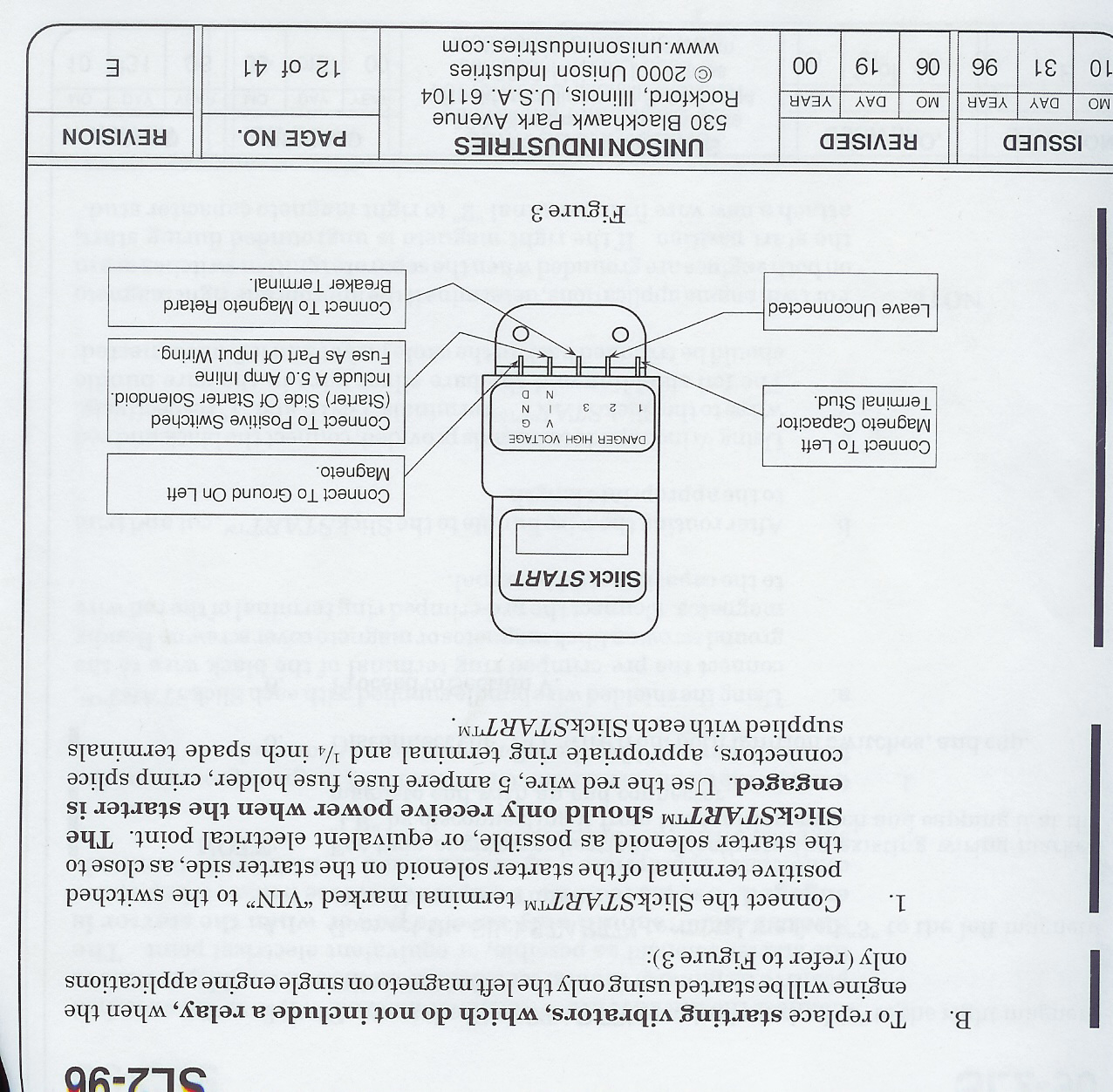

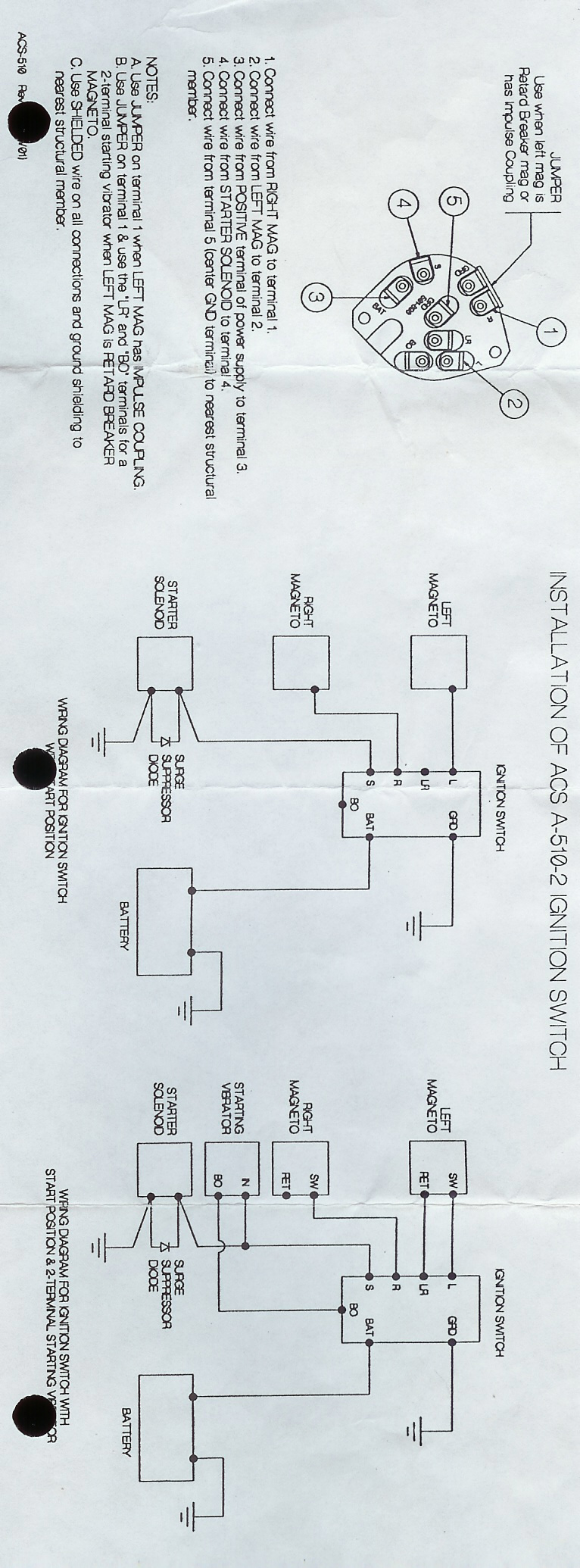

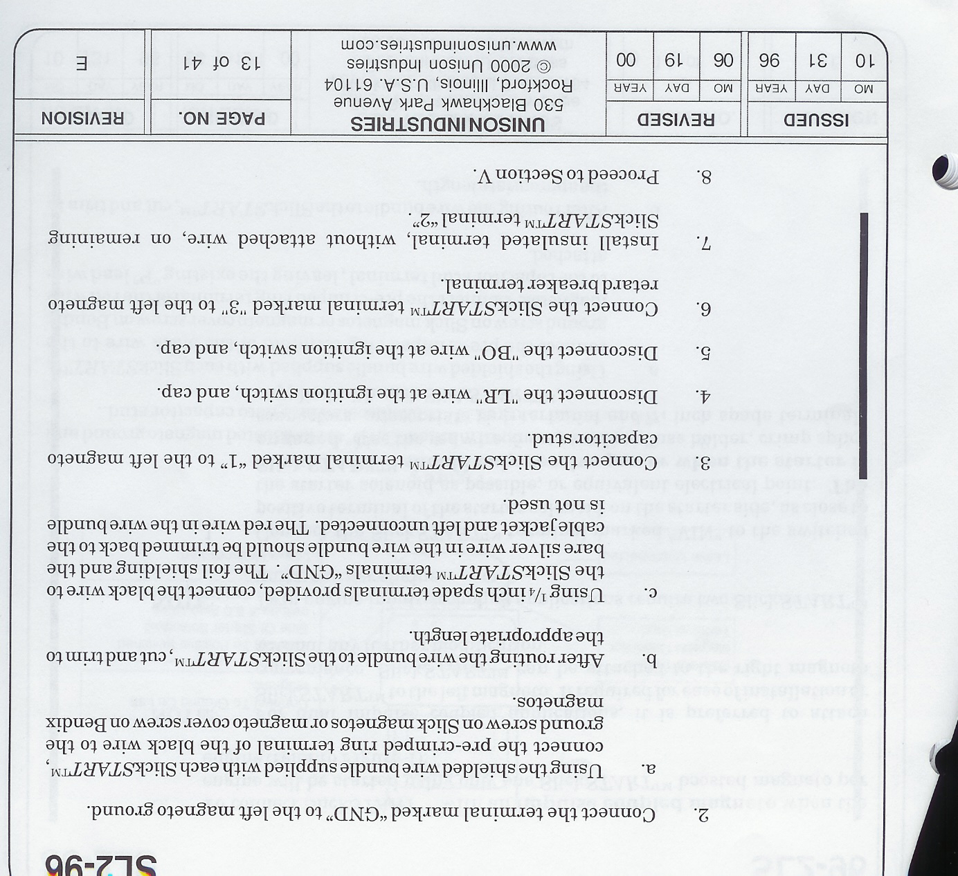

PostPosted: Sun Sep 13, 2009 4:49 pm    Post subject: Wiring diagram for Slick Start with 2 Slick Mags Reply with quote
Here is what I used to wire mine. I have attached the key switch
instructions and the pages from the Slick manual. Between the two, I
figured it out. Let me know if you have any questions....I will keep the
documentation here at home this week.

PostPosted: Sun Sep 13, 2009 6:09 pm    Post subject: Wiring diagram for Slick Start with 2 Slick Mags Reply with quote
I found this which describes my configuration exactly
http://alturl.com/dgvt
The only difference between what is described above and Fig 3 on page 12
of SL2-96 is the connection of terminal 3 to the "left mag retard
breaker terminal".
Any thoughts? I'm still staring at this stuff.
Bill "otherwise cruising along with the FWF work" Watson
Dave Saylor wrote:
Bill,
version:
<http://b2b.unisonindustries.com/pdf/marketing_literature/SL2-96%28E%29.pdf>
Dave
breaker terminal".

Dave Saylor wrote:
> Bill,
> version:

OK, I am no expert....but this is my best guess.........
Pin one grounds the Left mag capacitor stud for starting......
Pin two does nothing
Pin three provides excitation voltage to the retard breaker whenever the
starter is engaged.
Vin powers the unit only when the starter is engaged
GND ....ground for the unit.
When using a standard off, right, left, both, start.....starter switch, the
right mag is grounded when the key is in the start position. Note, the note
to jumper the GND and R... "JUMPER Use when lef mag is retard or breaker mag
or has impulse coupling." (See install of acs A-510-2 ignition switch.
On back of key switch.
L goes to Left mag capacitor (used to ground left mag)
LR (Not used)
R goes to Right mag capacitor (used to ground Right mag)
S goes to start solenoid
BO (Not used)
Bat goes to battery
GND to ground
I will see if I can dig up the key wiring......I remember seeing it

PostPosted: Sun Sep 13, 2009 7:10 pm    Post subject: Wiring diagram for Slick Start with 2 Slick Mags Reply with quote
Here is a connection to the Bob N article.....
http://www.aeroelectric.com/articles/MagnetoSwitchOptions.pdf
Also, I attached a copy of the key switch operation. Note, that in order to
get the Right mag grounded during starting, you need to have the jumper.
Good luck.

PostPosted: Mon Sep 14, 2009 5:55 am    Post subject: Wiring diagram for Slick Start with 2 Slick Mags Reply with quote
Rene, I think you gave me exactly the configuration I need to go with.
Thanks for the key switch function matrix - that's one I didn't have
though I have the wiring diagram and do understand how it should be
wired now.

> labeled but gone), and for SL2-96, there's a revision E and F that are
> distinctly different. Handling all these legacy setups in the certified
> aircraft environment looks really challenging for the manufacturers.
> For anyone with a stock 540 from Vans, with 2 Slick mags (no electronic
> ignition), and the standard key switch from Spruce, it appears you need to
> add the Slick Start module to the setup (which is not included in the FWF
> kit nor with the engine, nor is it doc'd anywhere I've found), and you need
> to wire it as described below. At least that's the conclusion I've come to
> with a lot of help from quite a few.
> Thanks all,
> Bill "developing a true fondness for my Lycosaur and its legacy
> technologies" Watson
>> starter is engaged.
>> the
>> note
>> mag
>> LR (Not used)
>> BO (Not used)
>> Bat goes to battery
>> GND to ground
>> somewhere.
>> Rene'
