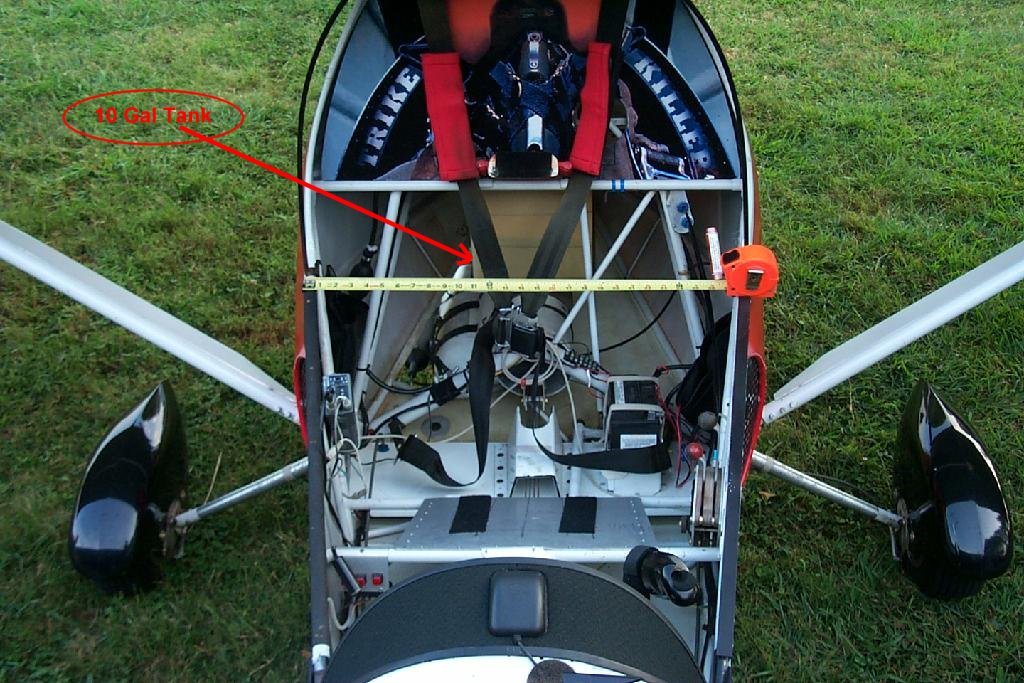

FireFly 11DMKI got mine from a place in Florida called
Rotational molding Inc.Phone 914-534-1766
Don't know if they have a web site or not.
Plastic powder is poured
into a mold and then heated as it turns. Comes out in
one solid piece.They make
"Gray Water" storage tanks for RVs.
You may like this site better http://www.ronco-plastics.net/marinetanks.html
It seems to have more choices. I like to be able to design my own stuff and I can see thru it (about 1/8+ thick?)
My plane is wider than Firefly - so you would have to measure the
space you have and figure out how to get it in. The holes are drilled and the fittings have to
be spun on at the factory with some kind of machine that melts them to the tank.
They are made of the same plastic that the tanks are made of.
If you tell them you are using it on anything that flys - they won't sell it to you.
We have used these tanks for 12 years, mine for 10+ and no problems
if the fittings are done right "raised" so you can also put a
clamp on the outside of the fitting after your screw in the connections (no leaks).
Don't have any good pictures of the tank by itself.
