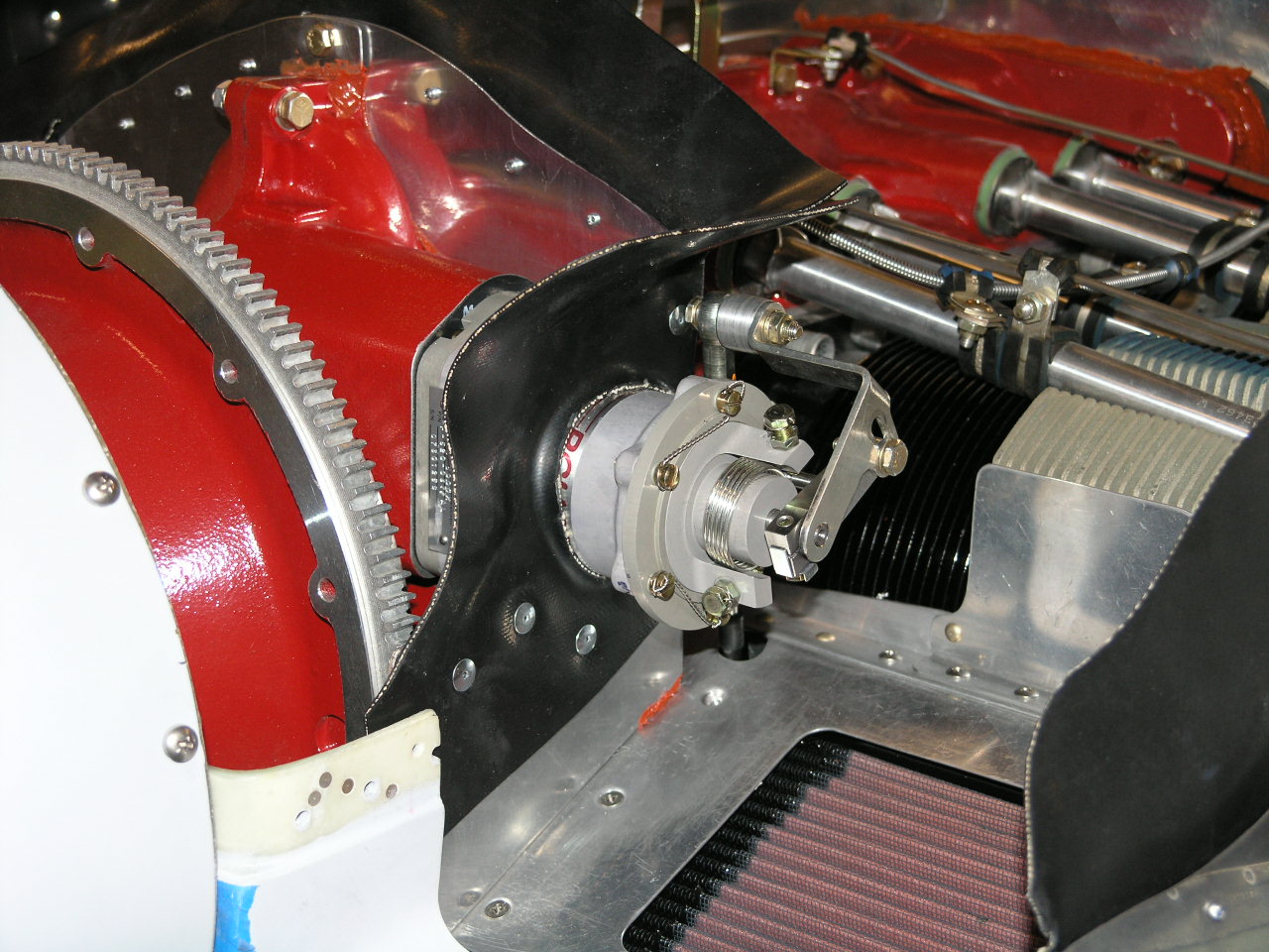

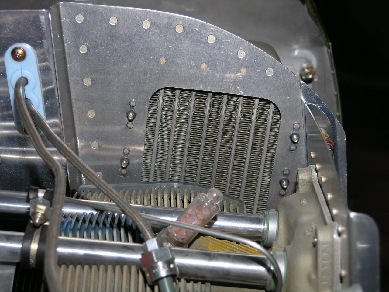

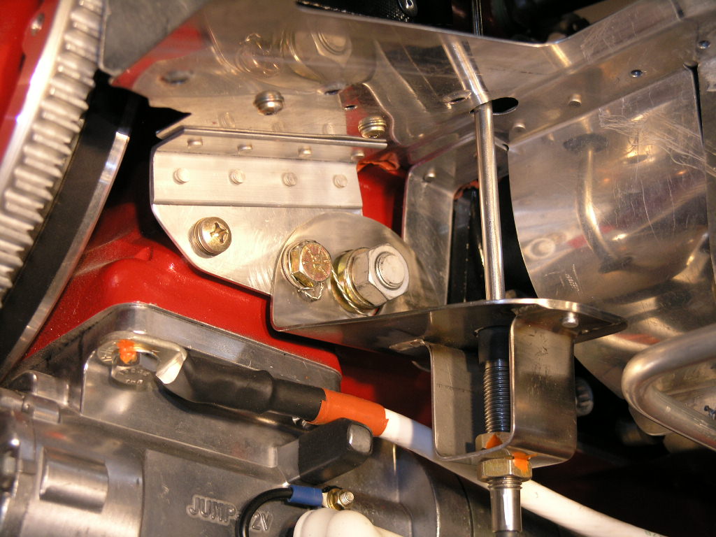

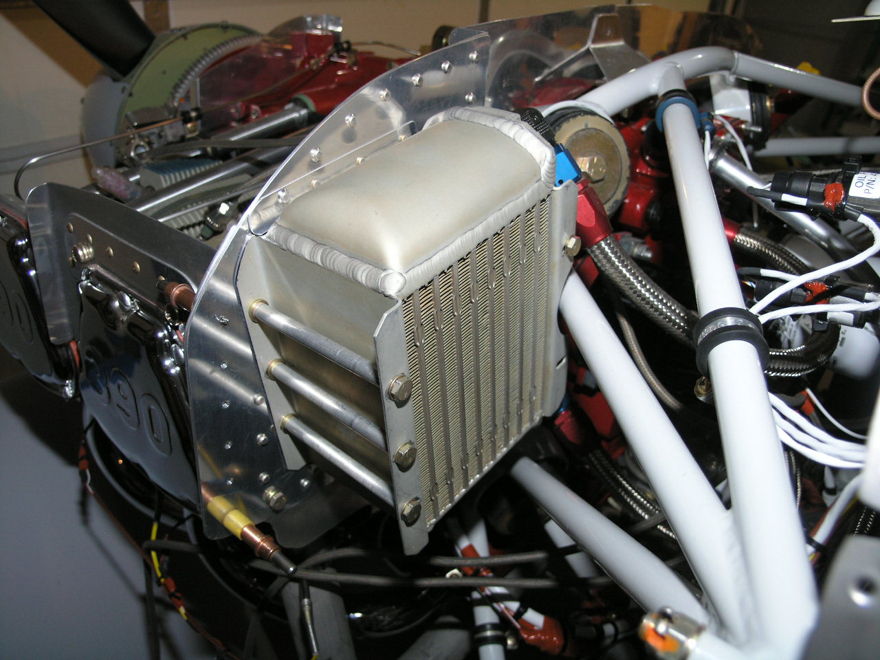

Hello Matt,
I installed the offset arm as well, but found that I needed an additional 0.5 inch offset -- fabicated from .5 inch aluminum stock. You might find the attached photos helpful.
Best regards,
Bill

PostPosted: Mon Sep 21, 2009 2:00 pm    Post subject: Re: Front Mounted Governor vs. Rear Mounted Governor... Reply with quote
Great pictures, Bill; thank you!
I just ordered a PCU5000 with the extension arm and the clockwise rotation (clockwise to increase pitch).
What length control cable did you use?
If you had made your bracket stick out a little farther, could you have gotten away with not using the extra bushing on the control arm?
