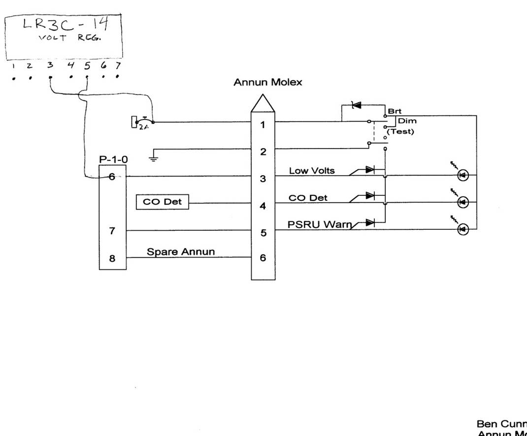

I recently purchased the LR3C-14 voltage Reg. for my RV7.
My panel was constructed by Aerotronics and I have added a diagram below of their schematic for my annunciator light circuit.
I have added a sketch below of how I would like to wire the LR3, with terminal 5 feeding the low voltage light through plug P-1-0/6, and terminal 3 reading buss voltage downstream of the 2 amp breaker. Since the light would be wired through a test switch, I wanted to run this setup by everyone to see if it looked OK.
Ben
