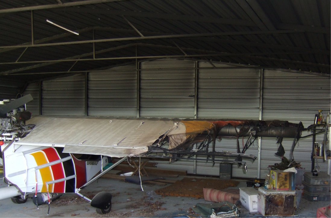

PostPosted: Wed Oct 28, 2009 5:55 pm    Post subject: Engine quits in Mid flight -Forced Landing- Fuel starvatio Reply with quote
I have been using the blue "see thru fuel lines" for the last 20
years and have never had problem - except the minor fire in the hanger
incident - hardly worth mentioning - considering the $100's of
dollars I've saved !!
At 05:41 PM 10/28/2009, you wrote:
George,
There is not such thing as clear fuel line that even comes close to
the safety and quality of Aeroquip or High Pressure fuel injection
line. The fact that you feel the need to change your fuel line
every year is an indication of how substandard the stuff is, it does
not matter what you paid for it. - snip - But most importantly,
everyone should have the facts about the disadvantages and dangers
of this type of fuel line and make an informed decision instead of
just copying what other ultralights do.
Mike

Sorry Beauford - I didn't get my video done - trying to survive the
R.E. market up here & hate to waste pictures.
