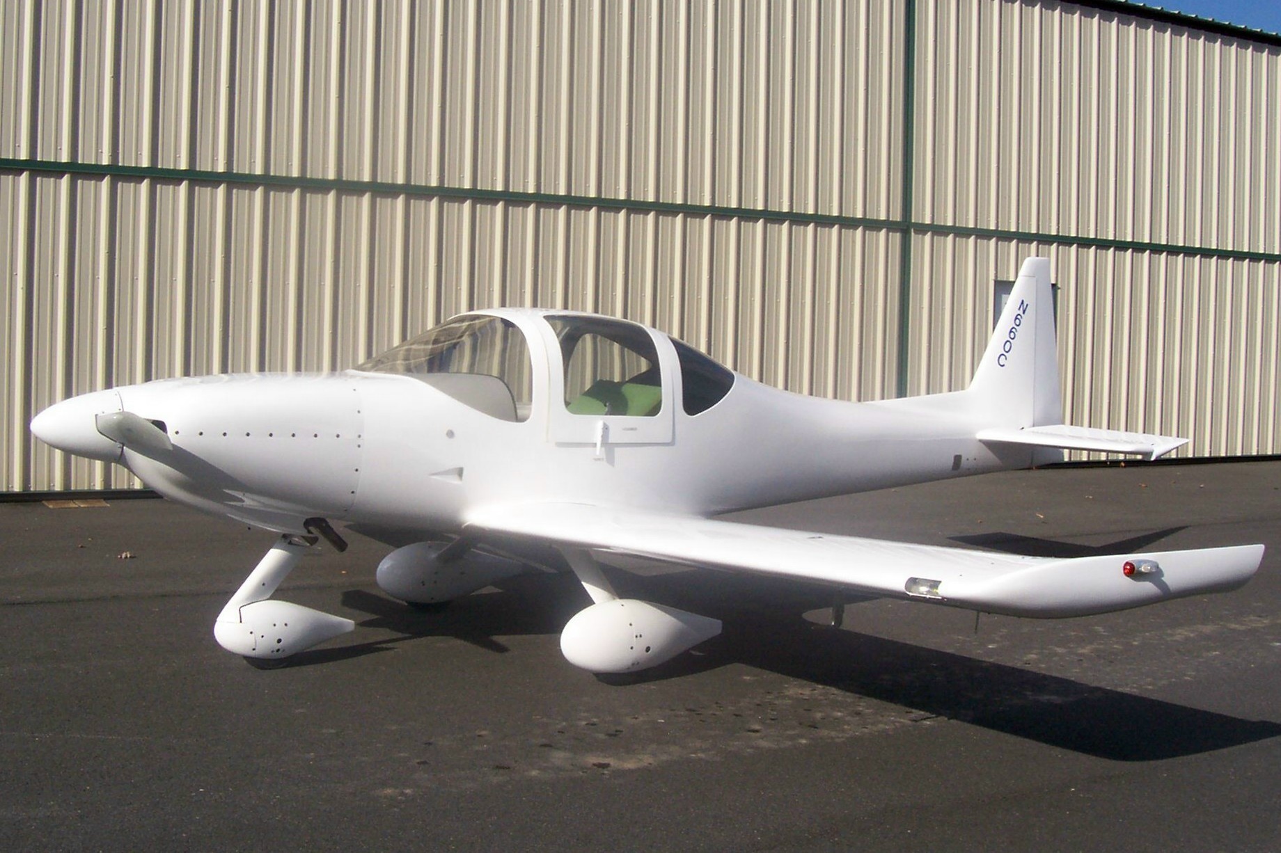

Yes I do, very much. I go flying at least once a week, weather permitting,
and I have over 265 hours on it now. Also I seem to enjoy working on it as
much as flying it. My last major project was modifying and installing RV
type wheel pants and wheel strut fairings on all three landing gear. I'll
attach a picture.
