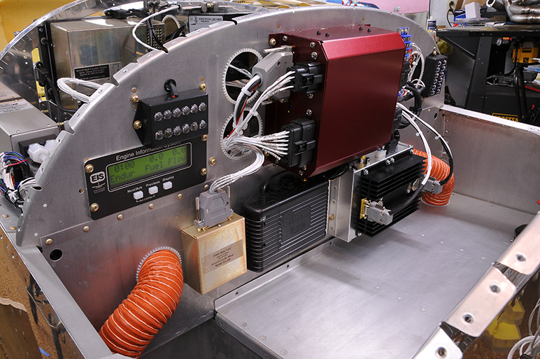

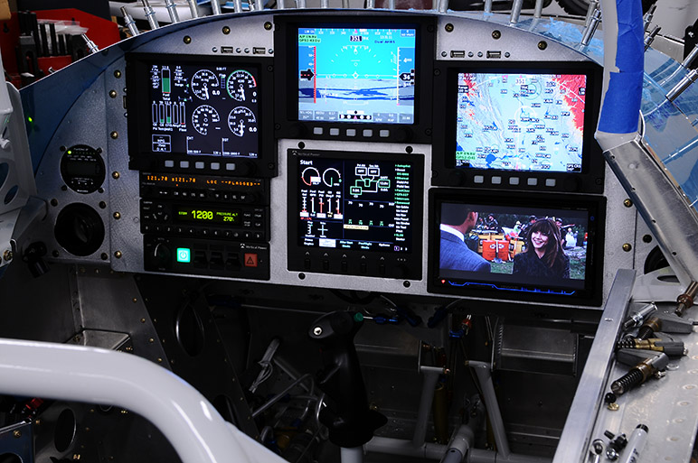

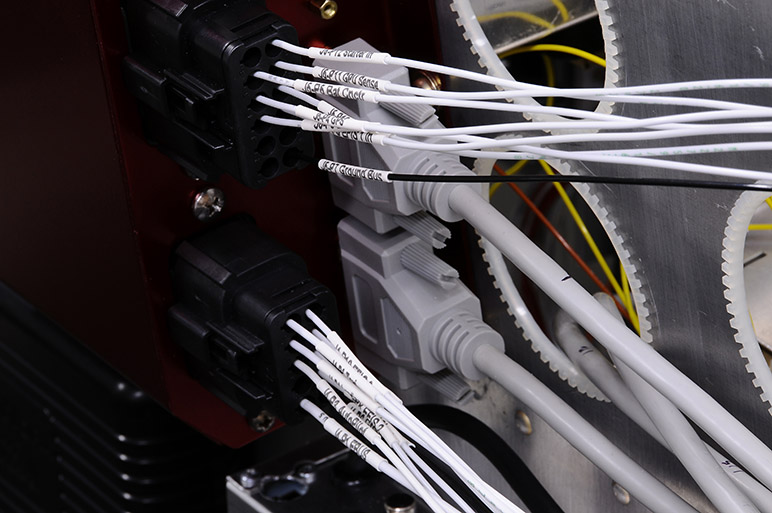

Hi Don,
I can't speak to the 24v vs. 12v issue and whether the Vertical Power solution would be the right answer or not. However, I can say that I have been extremely pleased by the functionality and ease of installation of the Vertical Power VP-200 system in my RV-8. The system is top notch all the way through, and the customer support from Vertical Power and Marc Ausman had been superb.
If you are at a point in your project where you can choose to install a Vertical Power system over traditional breakers and switches - DO IT.

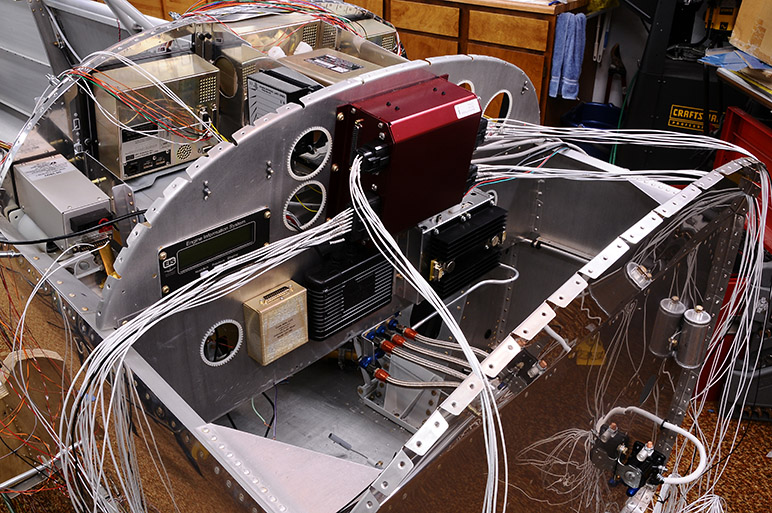

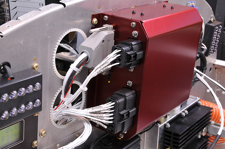

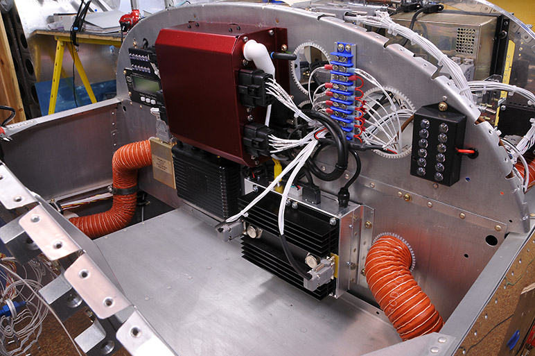

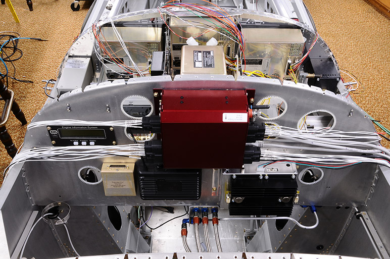

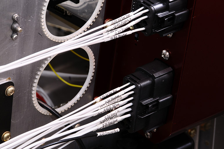

I've attached a few pictures of my installation. The big red box is the Control Unit and you can get those harnesses pre-made from VP. They just plug into the red box and you run the wire to the given device. Its just that simple.

[quote="Matt Dralle"]At 06:40 AM 12/12/2009 Saturday, you wrote:
Hi Don,
My Rating: 5/5
Matt Dralle
RV-8 #82880 N998RV
http://www.mattsrv8.com
Final Assembly
Matt,
Thanks (to everyone) for responding.
I'm already planning on the the Approach Stack solution.
And since I'm going with a two screen GRT panel, the VP-200 seemed like overkill so I was alternating between the VP-50 and VP-100.
Don Johnston

Rethink the over-kill, Don! I've got three GRT HX screens and the VP-200... See attached.
Matt Dralle
RV-8 #82880 N998RV
Final Assembly
 Filesize:  175.61 KB
 Viewed:  32901 Time(s)
Matt Dralle

PostPosted: Sun Dec 13, 2009 3:20 pm    Post subject: Re: Vertical Power? Reply with quote
Matt Dralle
Matt,
All I can say is... just damn! Cool
But I'm thinking about it from the perspective of I'll be using one of the GRT screens for engine monitoring. So the real estate of the VP-200 and many of the features (access-code, remote control, etc.) just didn't appeal to me.
Nice panel though.
-Don

Here is a link to my builder's log, specifically regarding the avionics installation. Lots of pictures and dialog describing the system. Let me know if you have any questions.
http://www.mattsrv8.com/users/category.php?user=MattsRV8&project=638&category 971
