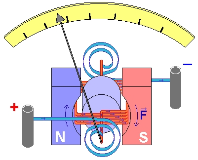

The AEC9035 was a proposed project that never
made it to the market. Too complex and too expensive
to build for the value delivered. Battery ammeters
are of limited utility and require a higher level
of understanding to be as useful as a simple LV
warning light and perhaps alternator load-meters.
In a system that's designed with attention to failure
mode effects analysis and complimented by (Plans-B
for critical failures), the ammeter offers no
useful data for operating the airplane. Its most
powerful function is as a diagnostics tool.
Hence, the market is small. We do offer a customized
kit for the installation of load meters on one
or dual alternator systems. These use the simple,
stable, accurate metallic shunts and simple, low
cost, pivot and jewel, d'Arsonval meters . . .
[img]cid:7.1.0.9.0.20091220093247.01d4f198(at)aeroelectric.com.1[/img]
See THE RIGHT LINKAGE here:
http://aeroelectric.com/Catalog/AEC/9007/9007.html
This approach proved the most elegant for ruggedness,
stability of calibration and cost of ownership when
the builder desires a panel display of current.
