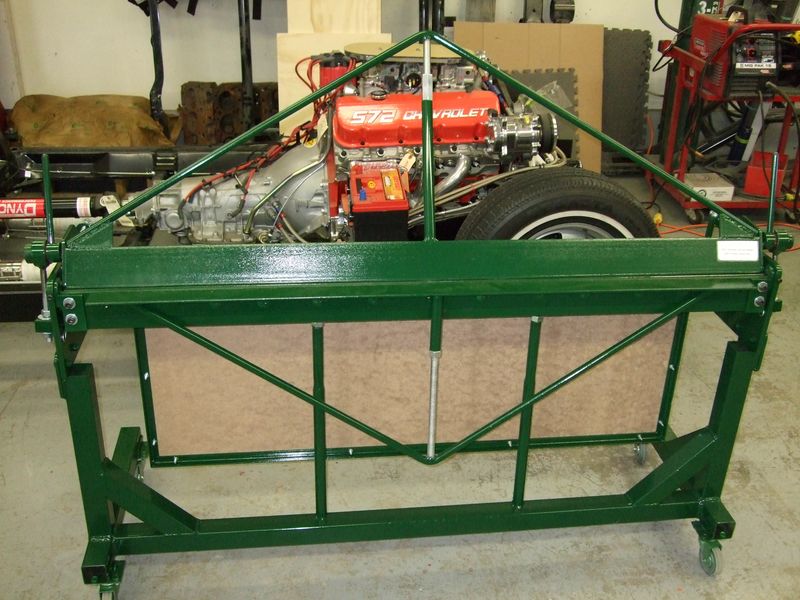

Please to make your acquaintance John, I live in Three Rivers, Quebec, just North of the US border, about two hours drive, from Champlain New York.
Personally I did not decide to go with the 701 or 750 for the gross weight, the load carrying or the STOL capacity, but rather because they are all aluminum aircraft, and by the same token, easy to build, and easy to repair. The fact that they can be left outside without any protection were not initially part of my decision.
The Zenith factory, now offer both aircraft in kit form, and also in partial component kits, ( as your Bearcat ) so that the builder can , as we say pay as they build. In my case, being retired, and trying to make ends meet on a small disability pension, did not permit me to purchase anything in kit form, so I was obliged to purchase raw material, and make up all the cutting, and forming block's. It goes without saying that this part of the build, was extremely time consuming, and the principal reason I decided to build the Mechmate.
As far as brakes are concerned, I originally built the 4' brake from the plans that are found on the CanZac website, ( see attached pic ) but I quickly realized that nothing but an 8' would be acceptable for the projects. The best brake project I have seen on the various Forums, is the brake offered by Mac's Machine and Design http://www.macsmachine.com/ he will sell you the plans ( right up your alley since one needs to have access to a machine shop to fab all the parts) and when your through, if you send him a photo of the completed project, he will refund your money. A win win situation.
Both Zenith main spars, don't need to be bent, since they are capped with extruded aluminum angle. As for the front and rear ribs, both the 701 and 750 are very similar, not enough to use the same forming block's, but very close. In my case to speed things up, I rough cut the blanks with my plasma cutter, then run them through a router for the final cut. Then the fun starts with the forming block's and hammer giving them the proper, 9 degree bend back angle.
All the the fuselage sections for both aircraft are cut from full length 12' sheets, so no shear is not going to cut it. Good luck with your project

That Macsmachine website brake is the one I was referring to also. I also have the parts for the 4' brake you mentioned, but I never put it together (yet).
