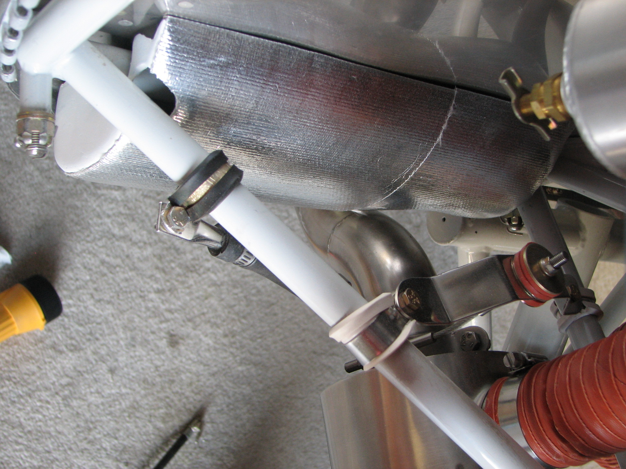

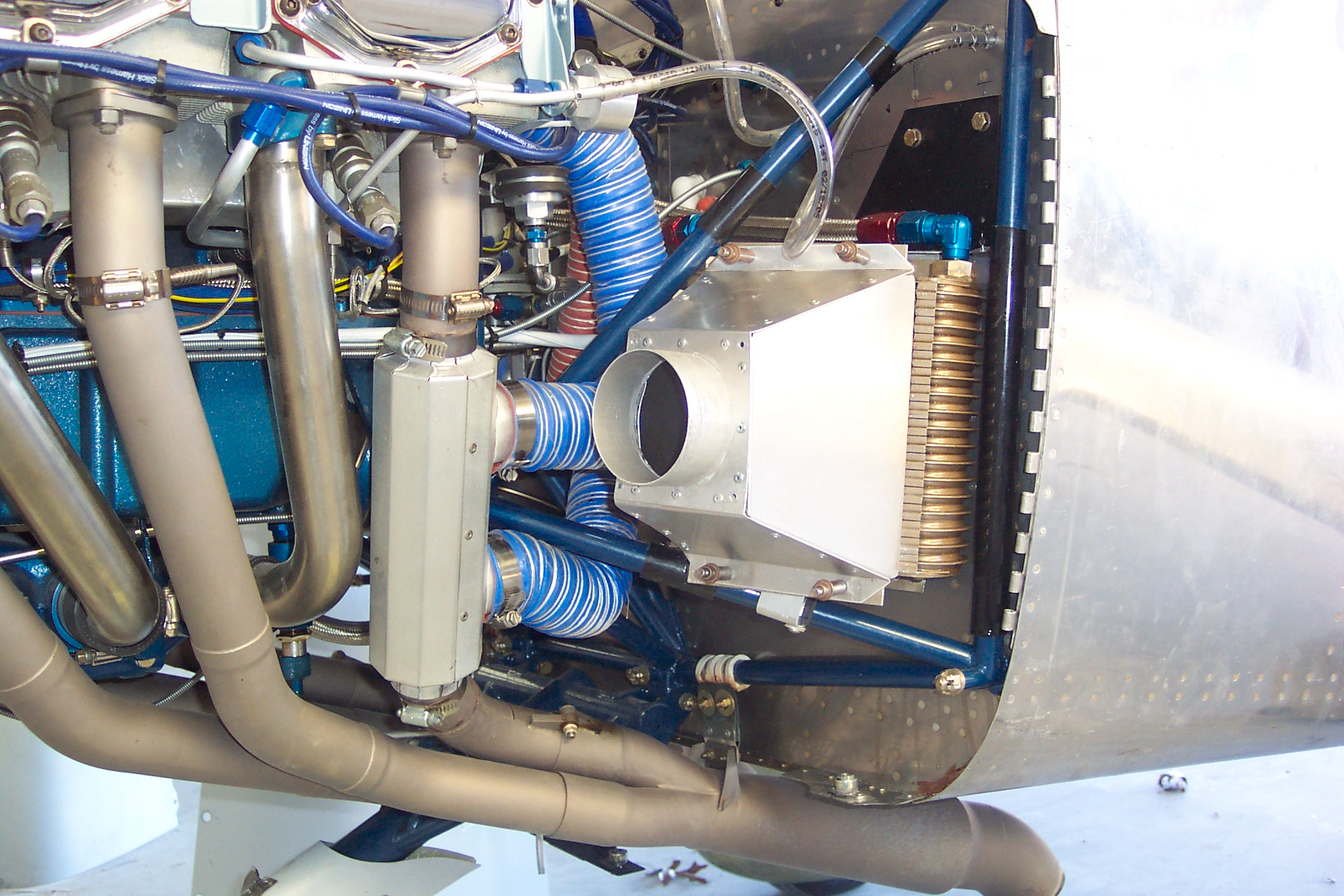

I am looking to get some ideas of doing the left exhaust hangar mount.
Does anyone have any photos of what they did? It seems a bit rube
goldberg as there is a lot of interference points: the air cooler, the
heat scat, tubes, etc. Any ideas would be great!
thanks
Jae

PostPosted: Mon Jan 18, 2010 9:33 am    Post subject: Left exhaust hanger Reply with quote
Same as the right for us.
Robin

PostPosted: Mon Jan 18, 2010 11:45 am    Post subject: Left exhaust hanger Reply with quote
Thanks Robin.. That firewall forward is quite heaviliy modified from the
stock setup, though. However, maybe i can steal a couple ideas from your
setup.
Jae

I am assuming you are using the stock Vetterman.... that being said, I tossed the original brackets aside, and built my own out of stainless. (I know several of you out there, just said, "of course he did").... It seemed to me that to be properly positioned the bracket needed to be bent, and the original bracket had lot's of mounting holes in it, which would have made it even weaker. The attached pics should help. Just zoom in on the first one to the actual bracket. I made a couple of extra if you're interested.
100+ hours and no problems whatsoever.

I did it per the (scant) plans with the Vetterman exhaust. I'm not a
metal work/rigging type guy but it worked much better than it looked. I
was able to position everything exactly as needed. Worked quite well
for this builder.
Bill "2 cents" Watson

PostPosted: Tue Jan 19, 2010 10:00 am    Post subject: Left exhaust hanger Reply with quote
Thanks Robin. I think this new setup might work well. Just mocked up now
and not final fitted yet. Robin used a clamp around the mount against
the firewall, which i had not considered. It actually looks like the
better spot for a clamp. There is much more clearance you can easily see
in the pics. It is a tight fit for the clamp but you can see the wedge
used to give a bit of room.
before:
http://picasaweb.google.com/lh/photo/A9mT9HXyj7yKkkz3NrP4kQ?authkey=Gv1sRgCI7088GZlYCc2AE&feat=directlink
after:
http://picasaweb.google.com/lh/photo/-ictyfdhx9QfrQrIAIFkvQ?authkey=Gv1sRgCI7088GZlYCc2AE&feat=directlink
The right side is much easier. The left side is more crowded because the
2 4 6 cylinders push the exhaust further aft. However, too far aft, then
the oil cooler starts interfering. The sweet spot is definitely smaller
on the left side.
Jae
