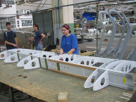

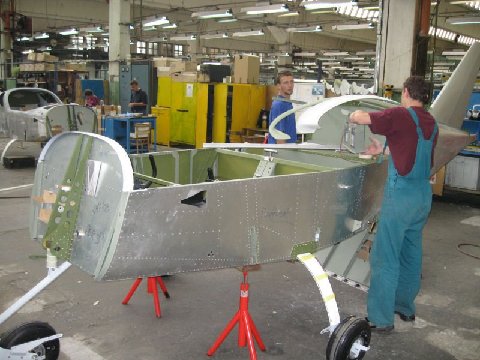

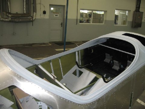

PostPosted: Fri Jan 22, 2010 5:47 pm    Post subject: Piper cruiser Reply with quote
Hey
in thefuselagee photo it looks like a fixed metal bar across the center below the Inst panel.. I wonder how much strength that makes??
Chris

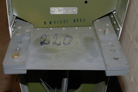

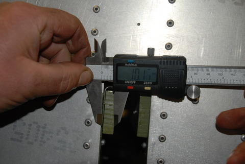

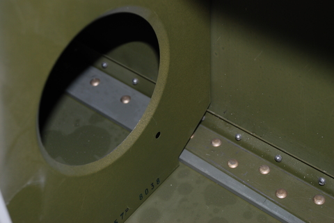

William Dominguez
Joined: 09 Apr 2008
Posts: 118
PostPosted: Fri Jan 22, 2010 8:14 pm    Post subject: (no subject) Reply with quote
They did copy the design, but they did some beefed up in the process, take a look at the attached photos.

I think a many people agree that the Sport Cruiser is at least a
descendent of, if not a rip off of the 601. A much better looking
plane though.
When I went to F&S a couple of years ago looking for a plane, I sat in
the SC mockup cockpit. That bar made plane a no-go for me - no knee
room. The 601 is what I decided to build. That bar is pretty
substantial. Based on what we now know about the weaknesses of the
601, that bar doesn't make a lot of sense to me.

The Sportcruiser interior and gear are identical to the CZAW Zodiac. That 2 piece main CZAW gear is only rated for 590Lbs. per side, but lighter in weight than single piece GROVE Gear by 30 lbs. or so. With the history of CZAW and Czech Sport Aircraft (check lists) poor customer support and business practices I hope Piper knows what they are in for. On the other hand if Piper can clean up that mess maybe I'll finally have a source for maintenance info and some parts for my CZ Zodiac since CZAW/Czech Sport Aircraft shut down or stripped their websites. Zenith sure as hell don't.
