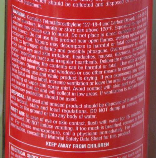

PostPosted: Fri Feb 05, 2010 8:53 am    Post subject: Brake cleaner and heat Reply with quote
This warning has been going around on other technical forums for a couple of months. Just an FYI.
Rick Girard
