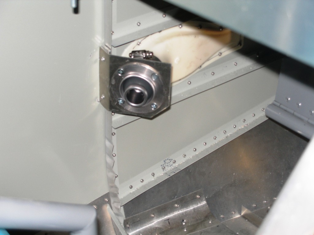

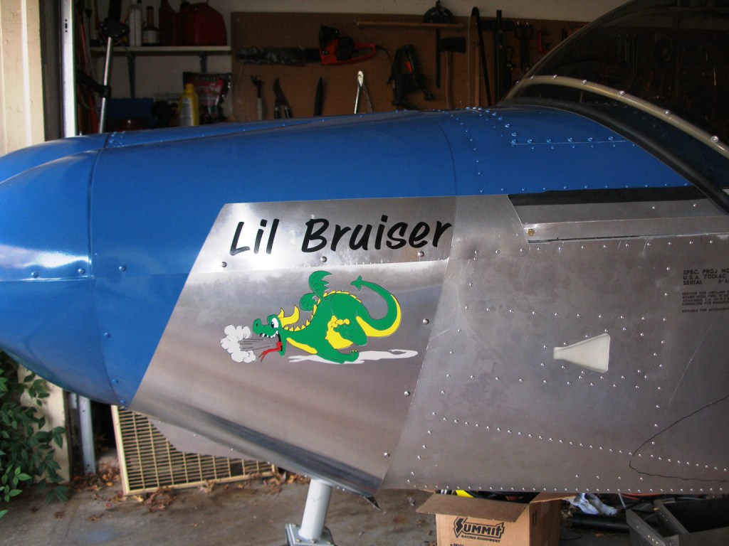

Chris,
The photo shows where I placed mine. I put it in that location and attached the eyeball outlet directly to the plastic duct outlet.
Jay Bannister

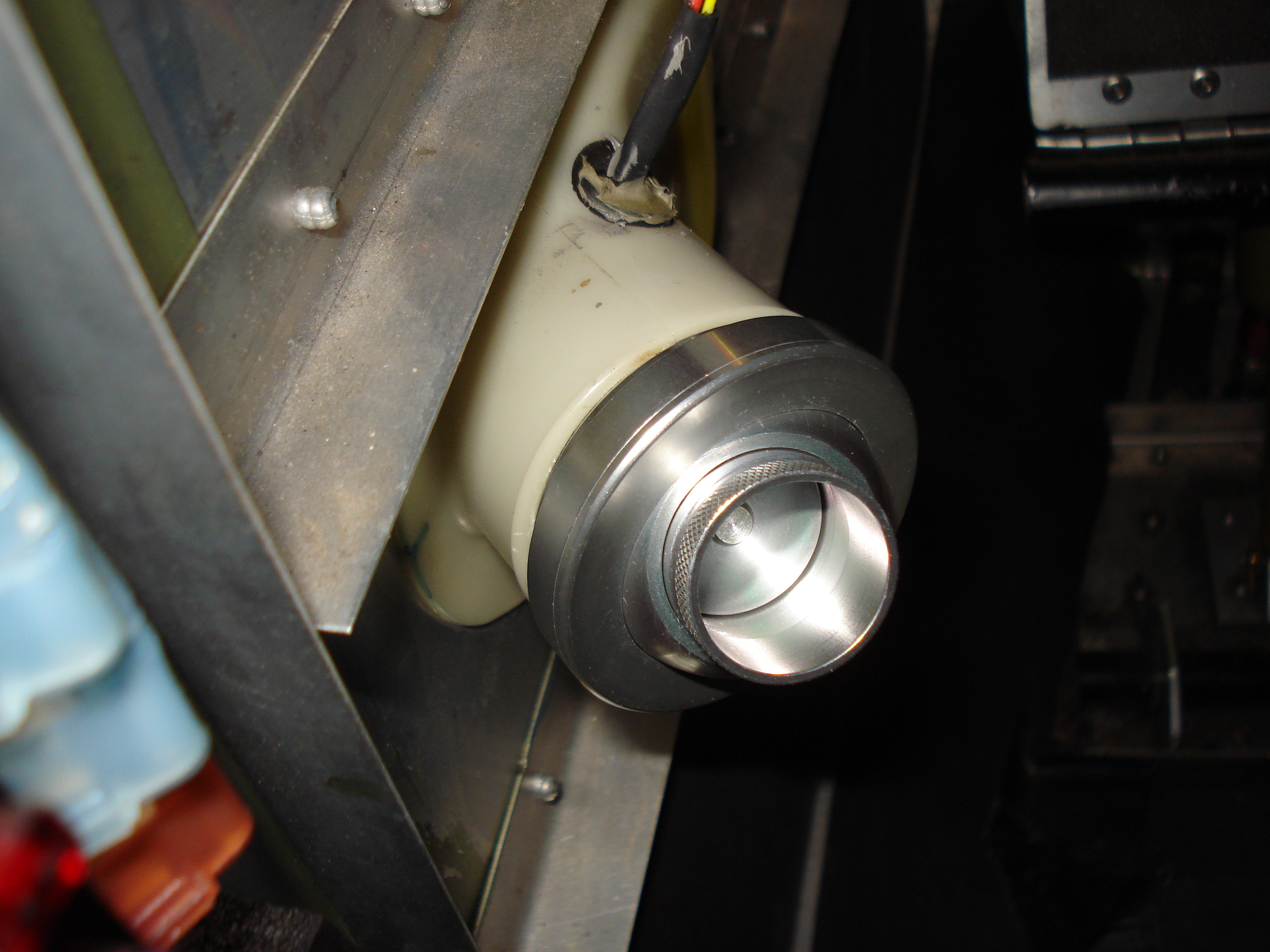

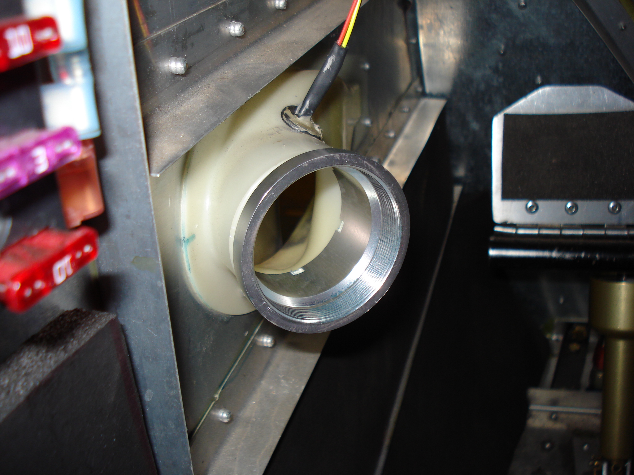

Hi, Chris!
My favorite solution is to used the aluminum Aveo Ball Vent with a 1.75" rear sleeve, popped right into the outlet of the NACA vent. A couple of wraps of tape around the sleeve makes for an airtight fit between the vent and the duct, and you're done!
Here are a couple of shots of my installation, one with the sleeve only installed, and another with the vent part threaded in. Easy peasy.
Rick Lindstrom
N42KP
