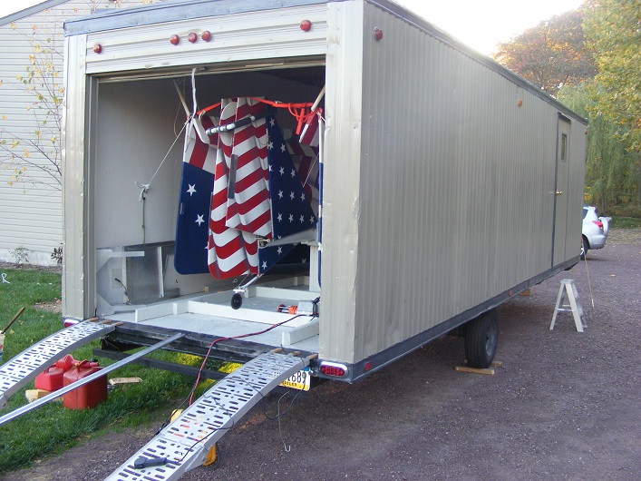

Hi Eddie,
Looks like I've got a similar thinking counterpart in the UK!! I also have a Worn Works winch mounted in on old job-site trailer I refurbished for a home for my FireFly. I have a solar charger http://www.northerntool.com/shop/tools/product_200263124_200263124 hanging in the window in the front of the trailer to keep the battery fresh, but rather than have a permanent battery for the winch I used a portable and clamped it to the winch leads, and would just take it home to recharge once in a while.
The attached pic is when the FF was secured for the ride to the airstrip, with the wings slung in cradles hanging from the roof and the tail boom in another cradle mounted on the floor.
After I positioned my trailer/hangar at the strip I took the wheels off, put them inside the front of the trailer, and have the axles resting on two sets of 4 X 4's just high enough to keep the brake drums from resting on the ground. With this lowered stance, and the light weight of the FF, I no longer use the winch. I simply hook a nylon strap in the lower strut receivers and easily pull it up the ramps by hand. I marked the point on the trailer floor where to stop the main gear wheels to go outside and line up the tail wheel with the track for it, which are a couple of traffic sign channels bolted together and configured to allow the engine to make it under the header, then raising the rear of the FF so the forward end of the wings (inside root of the leading edge when it's set up) clears the floor of the trailer.
Took some figuring, but it worked out really well. Twelve hundred bucks for the raggy trailer, a couple of hundred for new tires, some new lights, paint to make it un-ugly and free carpet for the area in the front for BSing over coffee with anyone hanging around the strip. The side door opens just at the front of the FF, so you don't have to squeeze by to get to the tools or coffee pot.
Nice to hear from your part of the world. Fly safe.
