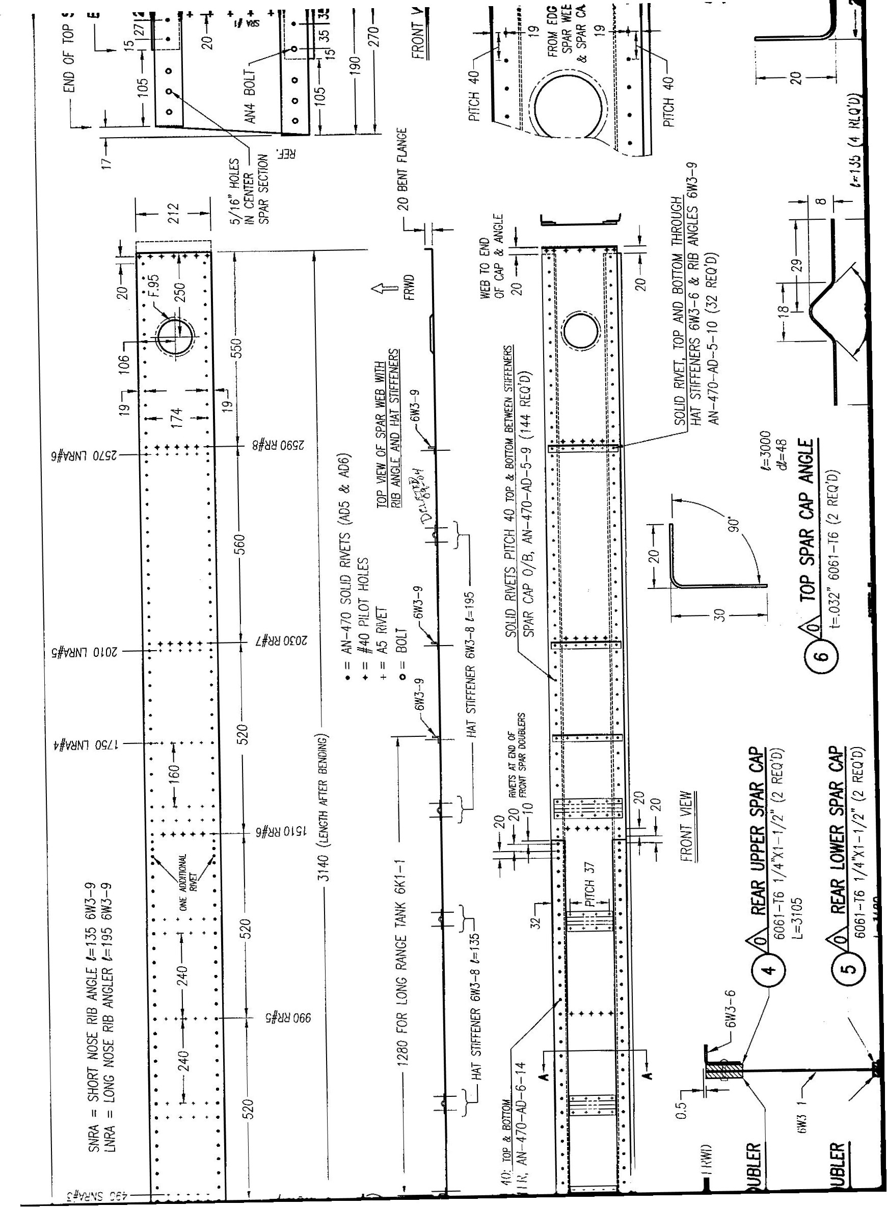

Sabrina wrote:
Hey guys… I am about to open up my wings between nose rib 5 and nose rib 6 to install mounts for my external main spar struts…. As I remember, the solid rivets are pitched 40mm on center.
Could someone tell me the actual distance between the driven rivets on the forward side of their main spar? (i.e. the space available on the front spar doublers between rivets) (As I recall, -5s are used that far outboard, so there is more space than further inboard where -6 rivets were used)
Thank you so much!
Sabrina

PostPosted: Wed Apr 14, 2010 9:34 am    Post subject: 601XL main spar question Reply with quote
Sabrina,
See attached. The spacing is 40mm along the whole wing except just inboard of rib 6 where the pitch is 20 where the front spar doubler ends 1465 from the root. One extra rivet each side of doubler end.
Al Rupp
Lake Placid NY
N765AR 601XL
