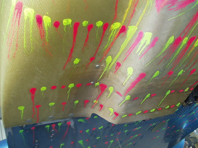

Project X: As soon as Brian's plane is gone and then Joe's plane and then 3 or so annuals, work begins on the Project X plane. It's an AG5B.
• The first step is to fix (i.e., correct) the poorly designed carb air inlet using as much hardware as is already there. The idea is to provide something that is simple to install and regains the lost inch of pressure.
Lots of plans for Project X.
Stay tuned.
