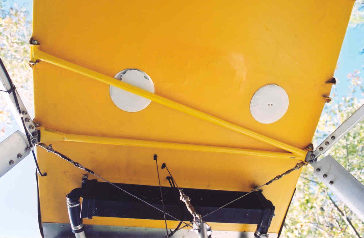

I recently received some info from a model 3 pilot flying Full Lotus floats.
He relayed " One item that was needed for floats on the models 1 through 3 is a brace across the bottom that I purchased from Skstar. "
I'd not heard of this before.
Does anyone have any knowledge or feel a need for reinforcement like this?
- see photo attached.

Posted: Thu Aug 24, 2006 6:30 am Post subject: Belly / float mount reinforcement |
It appears that Skystar engineering felt this area needed some extra
strength.
Deke

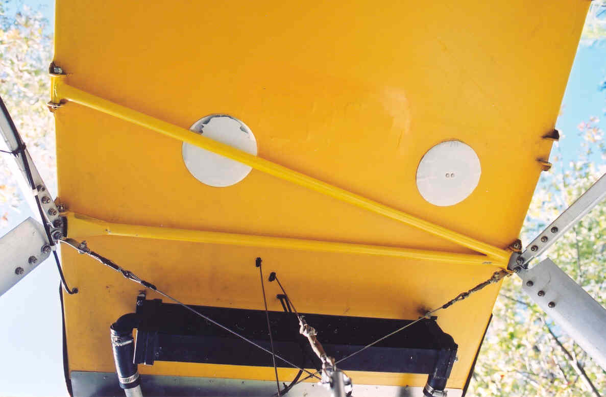

Dave relayed that my photo attachment (sent via web view) did not come through.
I'll dupicate my question here and try the attachment via Email.
I recently received some info from a model 3 pilot flying Full Lotus floats.<?xml:namespace prefix = o ns = "urn:schemas-microsoft-com:office:office" />
Does anyone have any knowledge or feel a need for einforcement like this?
Thanks!

I have not seen this brace before but I would certainly make one up if it called for.
Looks like a decent stiffner.
Now that is on front float gear attachment fittings. So Why would they not have one on the rear attach fittings as ther is more load there plus the added wing struts attach there as well.
I know some of the earlier Kitfoxes that is was a weak spot , expecially on hard landings.
Dave

I have that brace on my plane. as well as a strake under the vertical stabilizer. You can hit pretty hard if there is a decent wave at all so the brace seems ok to me.
Noel [quote]

I'm glad to hear about this support at this point 'prior to mounting'.
| Quote: | | Deke sez: It appears that Skystar engineering felt this area needed some extra strength. |
Yep, I guess so.
| Quote: | | Dave sez: So Why would they not have one on the rear attach fittings as there is more load there plus the added wing struts attach there as well. |
I'm curious also.
I welcome other input or experience.
