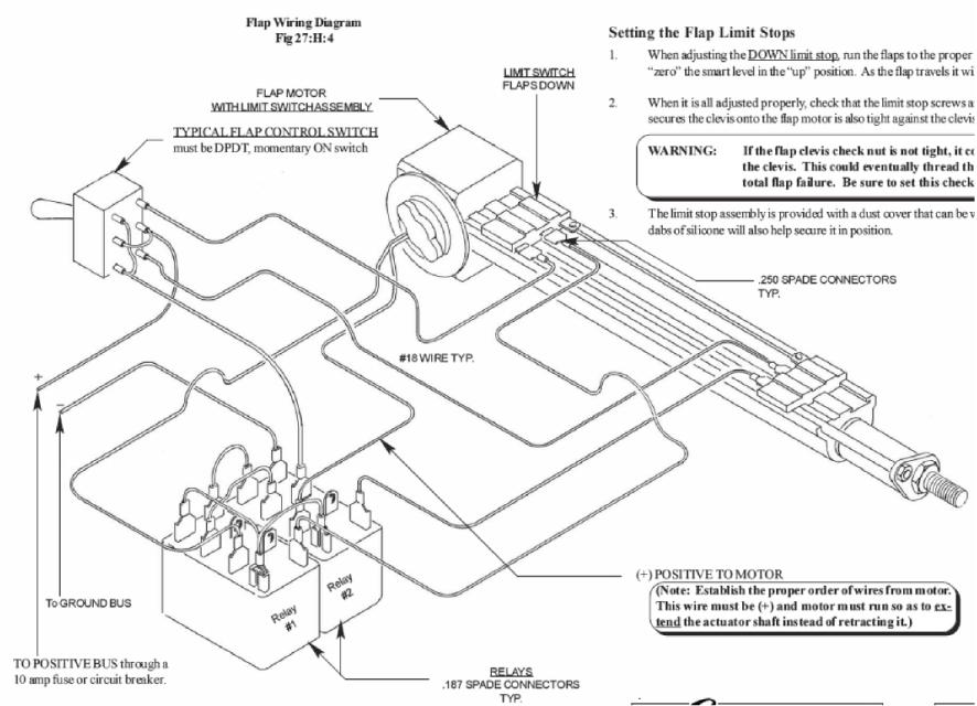

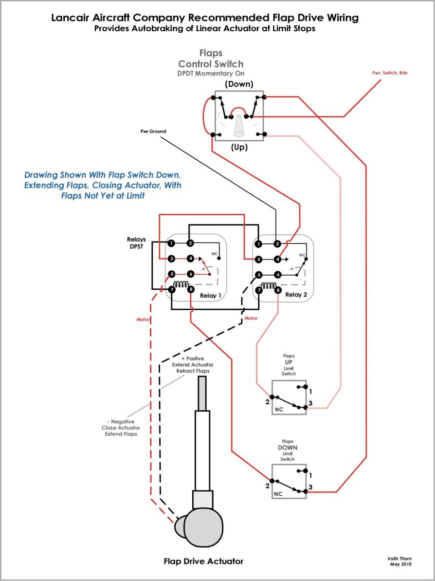

Hey Aeroelectric Gang,
I’m still working on wiring diagrams for our Lancair Legacy under construction. I have a question on the flap drive wiring I’d appreciate feedback on...
Rather than using a DPDT switch wired up to change polarity for the linear electro-mechanical actuator (EMA) to drive the flaps up and down, Lancair recommends two DPST relays with proper (see below) wiring to change polarity and provide immediate braking of the actuator. Without this circuitry the EMA will coast after releasing the switch which is a serious problem when the flaps are at their limits.
A couple of years ago, when we assembled and installed our flaps, I quickly wired this up and confirmed that without the relays it coasts quite a bit and with this relay circuit the EMA/flaps stop immediately.
So my question is, how does it accomplish this? I’ve attached my draft wiring diagram where I’ve created what I think is the relay circuit but am not sure. The wiring between everything is accurate. All Lancair provides in their manual is a pictorial of the relay wiring and a schematic of the circuit (see second image below). I’m having to guess that the terminals 7 and 8 in the relay circuit control the switch and that it’s normally closed to pole 2 (the relay schematic from the Lancair manual is the last image below).
Does this braking effect happen because of the collapsing solenoid field provides a brief voltage spike of opposite polarity?

Here’s my rendering of the flap drive wiring as I understand it:

When one selects neither up or down with the switch, the motor is
shorted by the relays (each side of the motor goes through its
respective relay's pins 5&6 through the NC connection to pins 1&2 which
are both connected to ground). The fact that they are connected to
ground is incidental. When the power leads of a running DC motor are
shorted together, the motor acts as a generator running into a short.
This almost instantaneously absorbs the rotational energy of the motor,
stopping it very quickly as you saw. If the leads were just disconnected
from power the only way for the rotational energy to dissipate is
through frictional losses in the motor and the flap mechanism - which
allows the whole system to coast to a stop as you found.
Valin
Lancair Legacy Project
Houston, TX USA
/Here’s my rendering of the flap drive wiring as I understand it:/

Ironically, I was looking at the Aeroelectric discussions from the last week and saw that Bob in another discussion last Wednesday related to flap drives already explained the motor braking is achieved by grounding (shorting) both sides of the motor rather than just opening the circuit…
“Note that in the OFF position, both relays
  are relaxed and the wiring places a dead short
  across the motor. This is ESPECIALLY useful in
  PM motors to supply electro-dynamic braking
  to the motor. Coasting is reduced to a small
  fraction of what you get when you simply open
  the motor's power circuit to shut it off.
  Bob . . .”

The wiring as you’ve drawn it appears correct and will function as desired. The second pole of the manual switch which is connected to your power source is not strictly required. Terminals 3 & 4 of the relays could go directly to your circuit protection bypassing the left pole of your switch. A SPDT momentary switch wired as the right side of your DPDT controlling the relays will give the exact same functionality. HOWEVER that second pole gives double redundancy for turning off power to the motor when you release the switch and is probably a good idea.
Also if I understand your explanation of how the flaps work on this aircraft it would appear that the notes on the wires leading to the actuator are incorrect. The drawing shows the red motor lead connected to positive battery power and the black lead grounded. Your explanation says this is extending the flaps and the down limit will stop this motion. The notes associated with the wires are contradictory. (Red lead negative (Therefore Black lead positive) to extend but it also says black lead positive (therefore red lead negative) to retract. Obvious contradiction somewhere). The drawing as shown supports your explanation and it is the notes which appear confused.

I would recommend using the circuitry that Lancair has in its manual. It
incorporates what Bob has mentioned (dual relays) in his response to you,
and it works very well - stops instantly when the switch springs back to
the central/neutral position.
I am on the road, but when I get home tomorrow, I can send you the page
from my wirebook with the wiring diagram and pinout of the relays. Let me
know if you want it. I could not download your diagram to enable me to
compare it to mine. Send it off line if you want me to look it over. IMHO,
this is not a circuit in your system that needs any modification.

Thanks Glenn and John. I wasn't proposing to change it. I wanted to
understand how the set up made the flap motor stop without coasting
and confirm that I'd reconstructed the relay's internal circuit
acurately. I understand it well now and think I captured the relay
internal circuit correctly.
