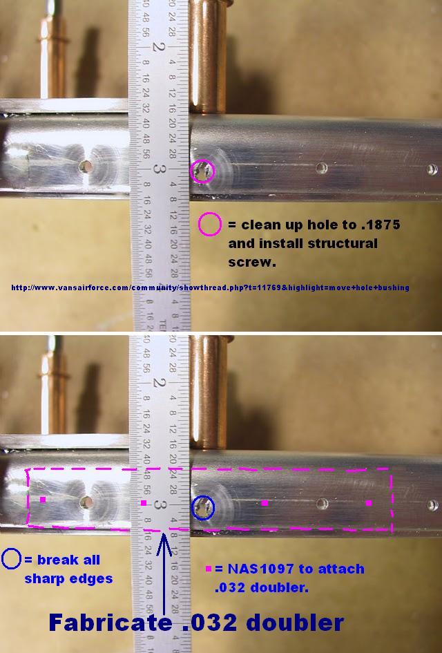

I've reached the horizontal stabilizer in building my RV-10.  While drilling the 3/32" holes in the spar doublers for the forward spar, I mucked one of the holes up.
In particular, the drill appears to have slid about 3/32" sideways while drilling, mis-placing the hole by 3/32".  Perhaps better explained through pictures:
http://picasaweb.google.com/lh/photo/YZEMcGR7IQ7RKKSRLDgTIKIqw9YRHPUJIjz5HHlTjwc?feat=directlink
http://picasaweb.google.com/lh/photo/eN0TsDBeAFqGoRwnEt8-s6Iqw9YRHPUJIjz5HHlTjwc?feat=directlink
http://picasaweb.google.com/lh/photo/e83Ltq54S8AOdpT-fXhSuKIqw9YRHPUJIjz5HHlTjwc?feat=directlink
http://picasaweb.google.com/lh/photo/JklKOOxA-qYDu9BtPMZJeKIqw9YRHPUJIjz5HHlTjwc?feat=directlink
So I know how to fix a hole when you make it slightly too large -- you drill it out larger and put an "oops" rivet in it.  But what can you do to fix a hole which is misplaced?  Is there a good fix for this?  Drilling a hole large enough to cover this error would take a rivet larger than 1/8"...
(At worst, I can just replace the spar -- I have a spare, due to an earlier error that Van's made, and so I'd just need to order some new spar doublers.  But I'd like to first learn if I can fix this one.)

It's only one hole of tens... not a structural issue... you could do your best with an oops rivet and move on. Is it a cosmetic issue with the skin? You don't show the skin... is the skin bungled-up also? You could fill around it on the exterior skin cosmetically with pro-seal when you mix it for the tanks.

You could countersink the mis-drilled hole and put a flush rivet in it, under the skin.  Then using the pre-drilled skin as a template, drill the correct hole in the spar, and continue on.  I'd think that one repair on the spar wouldn't have much if any effect on the overall strength.  If you're concerned about the strength of the spar cap you could put a doubler under the existing row of rivets that picked up 6-8 holes.

[quote] This is a slightly unusual assembly in the RV-10.
The spar comes pre-drilled with undersized holes in the flange.  The doubler comes with no holes.
You clamp the doubler on the spar, and drill through the existing spar flange holes and through the doubler with a 3/32" drill.  When you later assemble the whole thing with the skin in place, you match drill everything (including the skin) with a #40 drill.
So for this hole I've messed up the spar flange and doubler, and now have a misplaced hole to go under my pre-drilled skin (which I have not touched yet).  I was hoping to find a solution which does not involve:  (a) drilling another hole right next to the first mistake, since that would weaken the spar flange, or (b) making my skin look ugly.  I fear this solution doesn't exist...
Chris

PostPosted: Tue Jun 01, 2010 1:30 pm    Post subject: Fixing a bad hole... Reply with quote
Chris,
I see at least two ways of addressing that particular problem:
First fix option: You could "pull" the hole over and clean it up although I suspect it may need to go up to .1875 to do that perfectly. Then after dimpling, the hole would require an AD6 rivet or more likely....a structural screw. The problem is you likely do not possess the proper tooling to clean up the hole and even if you did, any 3/16" fastener would stand out like a sore thumb among all those AD3 rivets. Still, here is a link to "builders tip" I once wrote that describes the technique of "pulling" or moving a hole over:
http://www.vansairforce.com/community/showthread.php?t=11769&highlight=move+hole+bushing
Second fix option: This fix is what I would be inclined to do, because in the end you can install a regular AD3 rivet in the bad hole as if it never existed. Using a pattern file or similar, clean up the bad hole in the spar so no sharp edges exist. Then fabricate an .032 doubler of a given length. You could install that doubler by simply picking up a number of existing holes in the spar OR you could fabricate it as shown in the second picture by riveting it in place using a total of four NAS1097 rivets through the spar and doubler. Then later, when the skin is clecoed into place, use the subject hole location on the match hole skin to drill through the doubler. The over-sized spar hole would be effectively ignored. Care must be taken to insure whatever dimpling you do to the spar is effective. Done properly, nobody but you will ever know.
Rick Galati
RV-6A
RV-8
 Filesize:  83.62 KB
 Viewed:  10805 Time(s)

I agree with this approach. Done properly, there should be no strength
compromise. You can also slightly countersink the underside of the bad
hole, to give the shop head a better grip.
In fact, I know there are a number of RV 10 wings that have this sort of
repair where the plans call for one single lug nut plate in the middle
of a bunch of two lug nut plates. Before long you will learn how to
efficiently repair your mistakes, the plan mistakes, the QB facility
mistakes, etc. In fact, fixing mistakes is one of the better skills you
acquire as you move along.
There are some who say you should just pick a finger to drill through,
with a small bit, so it isn't a surprise when it happens. Since I had
already done that long ago working on the motorhome type of RV, I
figured I didn't need to repeat the experience. ;-p
6-8 holes.

Of all the rhetoric this thread has generated, I find the suggestion of
making the hole 'clean' to accept a rivet .... put one in, and then use
the skin as a guide to redrill the hole .... with a good bit. As Kelly
said in a previous post .... fixing (not replacing) an oops will become
a common skill.
Linn
Kelly McMullen wrote:
Sounds like your drill bit was either bent, or not installed straight
in the drill. You shouldn't get that kind of wobble from a drill bit.
You can keep a few pieces of scrap to test a drill bit on before
doing critical parts, and to fine tune your rivet gun pressures before
driving any that will look bad if not driven right.
Don't feel bad. I know one or two people that misread the instructions
and misdrilled those doublers, needing to obtain new ones. When you
get into wings and fuselage you will forget all those minor speed
bumps on the tail.
