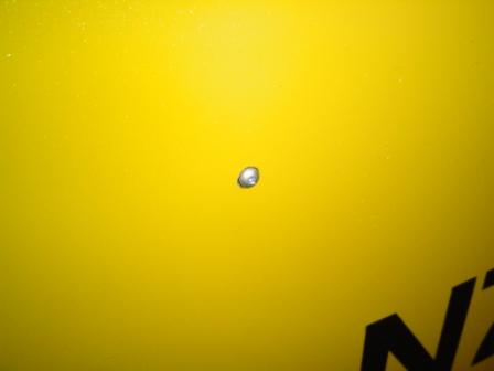

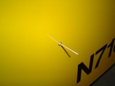

PostPosted: Sun Jun 06, 2010 9:24 am    Post subject: static port Reply with quote
Same exact problem I had on my 8A.
I drilled a 1/16” hole in the center of a couple of 1/8” AN470 rivets.  After drilling the hole I used a Dremmel tool to cut off the rivet shank, then sanded flush.  I used JB Weld to epoxy the rivet heads to the flush static ports, putting a shaved down toothpick in the hole to both hold it in place while the epoxy cured and to keep the hole clear.  Photos attached.
After 200 hrs still working perfectly.
For the RV-10 I’m using a couple of 3/16” AN470 rivets with a 1/16” hole drilled through the head and the rivet shank.  I’ll just epoxy the whole rivet in, then glue on the ¼” static line over the rivet shank.
