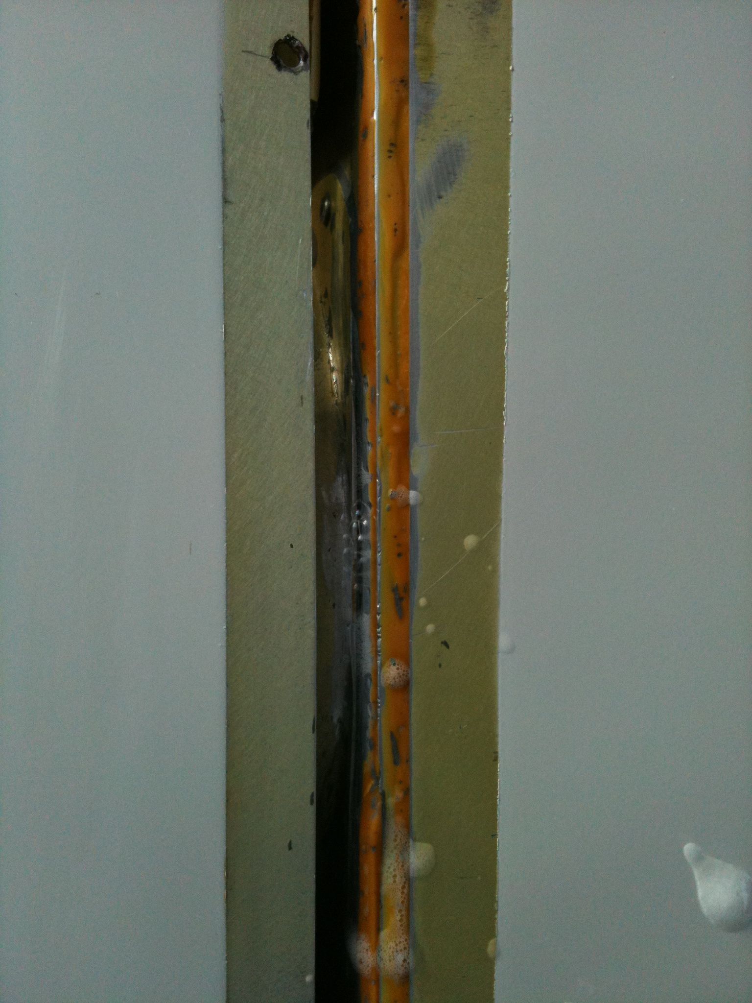

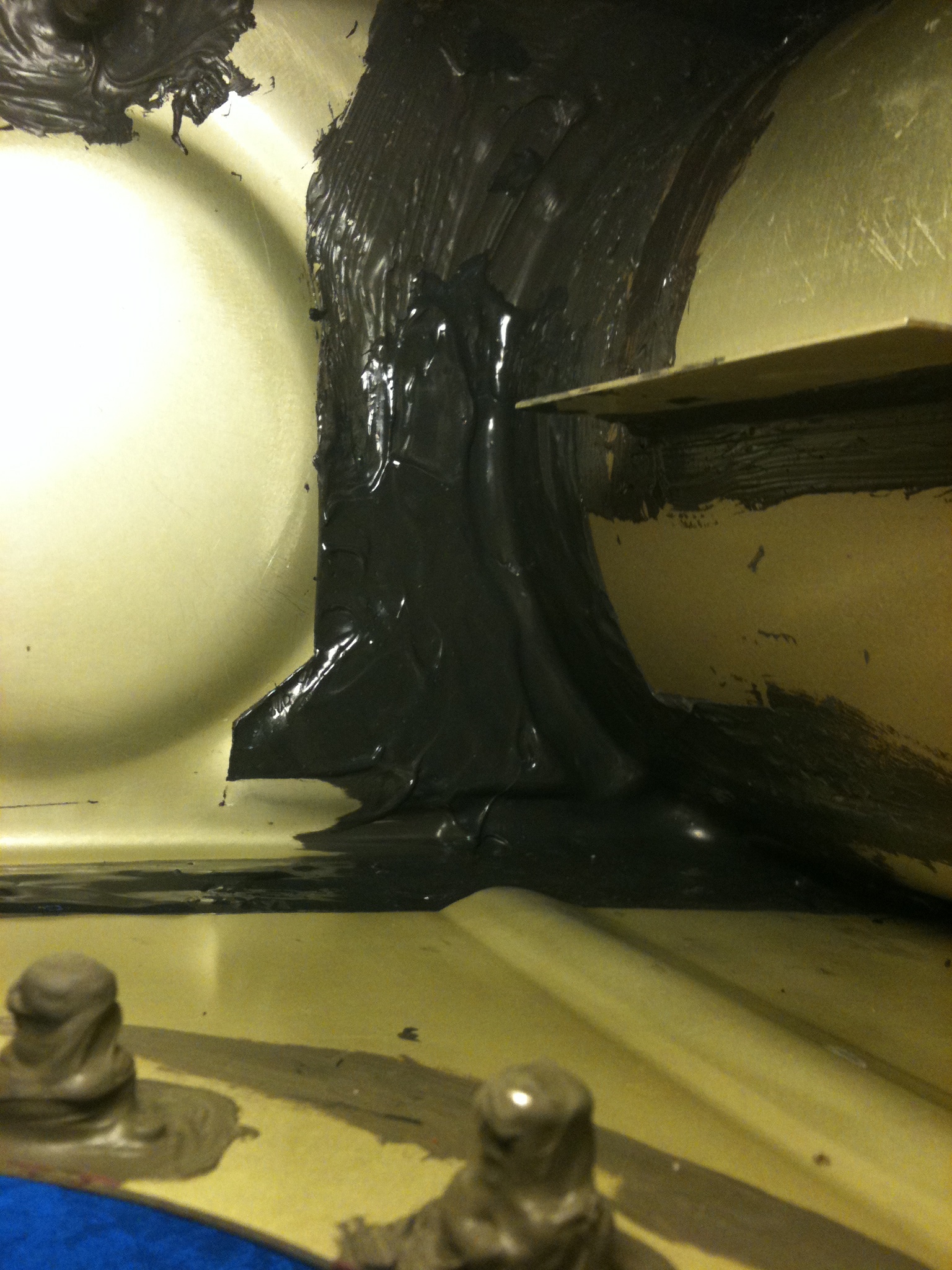

teamgrumman(at)YAHOO.COM Guest
Posted: Fri Jun 18, 2010 5:48 pm Post subject: Fuel leak |
After I cleaned out all of the sealant on the OUTSIDE of the tank, I pressurized and squirted on soapy water. You can see it in pic 1359. The other side of the leak looks like this: 1258. About the only ay I can see that it would still be leaking is if it is coming in at the top and running down the inside between the rib and any doublers. What a pain.

| Description: |
| Filesize: |
1.08 MB |
| Viewed: |
4412 Time(s) |
| Description: |
| Filesize: |
1.06 MB |
| Viewed: |
4412 Time(s) |
