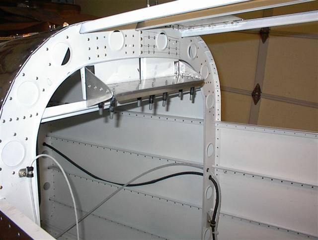

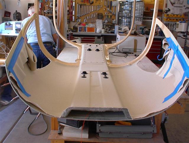

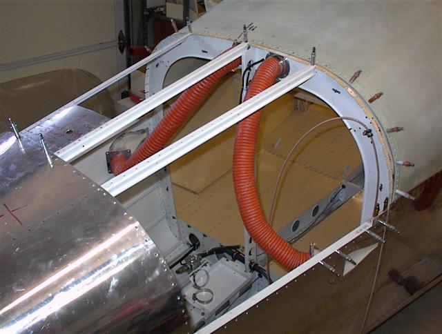

I'm not sure what you are asking but this is how I got air into the overhead
console. It has 4 eyeball vents and 4 small lights. I used the same NACA
vent assys that are in front because I could easily attach a section of
screen.
Albert Gardner
N991RV
Yuma, AZ
