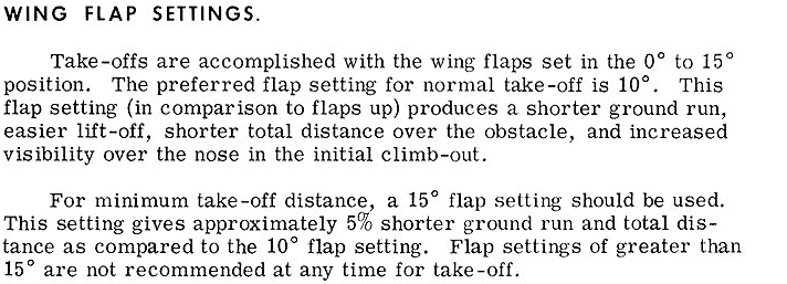

PostPosted: Mon Jun 28, 2010 7:53 pm    Post subject: Using flaps for takeoff Reply with quote
POH for a C170B last produced in 1956? Surely you jest. It had a one page 5X8" two sided FAA approved flight manual. You climb at Vx, which for most planes is flaps and gear down. Best angle of climb, which is what you need when obstacle is near. The FAA short field definition rarely meets real world...paved runway, just short distance to obstacle. Most real world short fields are also either soft or rough fields and flaps are needed. Just my experience in 700 hours of flying 170B in Alaska. Instructors teach what the FAA dictates to pass the test. I do happen to have a C177B POH handy, which calls for 10 degrees for normal takeoff and 15 degrees for max performance takeoff:
[img]cid:part1.04030601.09070902(at)aviating.com[/img]
[img]cid:part2.06050302.01040504(at)aviating.com[/img]
On 6/28/2010 5:24 PM, Scott wrote:
--> RV-List message posted by: Scott <acepilot(at)bloomer.net> (acepilot(at)bloomer.net)
I can see how 10 degrees might lessen the takeoff roll due to being able to lift off at a slightly lower airspeed. Can anyone explain why the obstacle clearance would be better with flaps down? There is more drag, so wouldn't rate of climb be slightly less? I suppose if you climb at just above stall speed, your ground speed would be lower, thus taking longer to get to that tree line? So, why do instructors teach flaps for soft field and no flaps for short field?
What does the POH in the 170B say about soft and short field ops?
Scott
Kelly McMullen wrote:
--> RV-List message posted by: Kelly McMullen <kellym(at)aviating.com> (kellym(at)aviating.com)
Well, I can tell you that in a Cessna 170B and up, flaps shorten takeoff roll and clearing an obstacle until DA is more than 4500 ft. The old ones used 20 degrees until the 172 added a notch for 10 degrees and that was what was used. The Mooney uses 15 degrees of flaps for all takeoffs unless crosswind is too strong to handle with flaps, regardless of DA.
