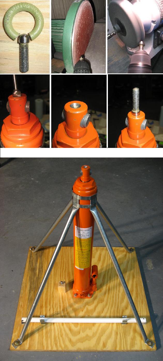

I use two entirely different methods to jack up my RV-8 and both systems work very well. The first method uses a commonly available bottle jack from Harbor Freight. Many builders before me have made their own version of a wing jack based upon the HF bottle jack and my interpretation is no exception. Investing just a few hours work using off the shelf parts, the Harbor Freight bottle jack be quickly transformed into a very useful wing jack.
http://tinyurl.com/7eb5ed

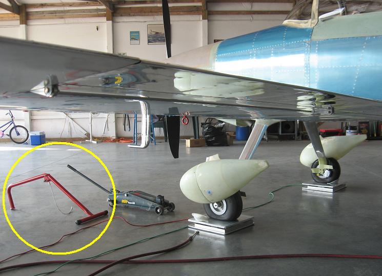

The second method I use is the "Handy Jack."  Using leverage, it too is a quick and very easy way to lift an RV8 wheel clear of the floor.
http://www.rvtraining.com/html/atp//html/products_pics.html#RVJACK

Rick,
Did you make any kind of stabilizing frame for the bottle jack or use them
as purchased? Would be interested in pictures or description if you made
stabilizer.
I too have a set of the HF bottle jacks. A "pocket" was created on the top
of the shaft to fit the plastic screw in buttons in the tie down fixtures
( from Van's) Did this with a large counter sink tool. This makes a secure
point at the wing. But, I am always a little concerned about the jack
tipping while jacking or if I bump the airplane while on the jacks - even
with the other wheel chocked.

Dale,
I made up the jack in about 4 hours using a 2'X2'X3/4" precut piece of plywood as its base, two 3-1/2" band clamps and one 10' stick of 1/2" electrical conduit all purchased from Home Depot. In practice I find the jack to be very stable. Perhaps it helps that the ball joint I fashioned from a spare tie-down ring is allowed a small degree of movement within its socket on the jack itself and that allows the ball to find its own center under load while lifting the wing.
Rick

PostPosted: Thu Jul 01, 2010 1:44 pm    Post subject: Jacking Point Reply with quote
For my RV8, I have the handy jack from avery. Works great and nothing is in the way when taking the wheel off.   http://www.averytools.com/p-913-the-handy-jack-eldorado-aviation.aspx
