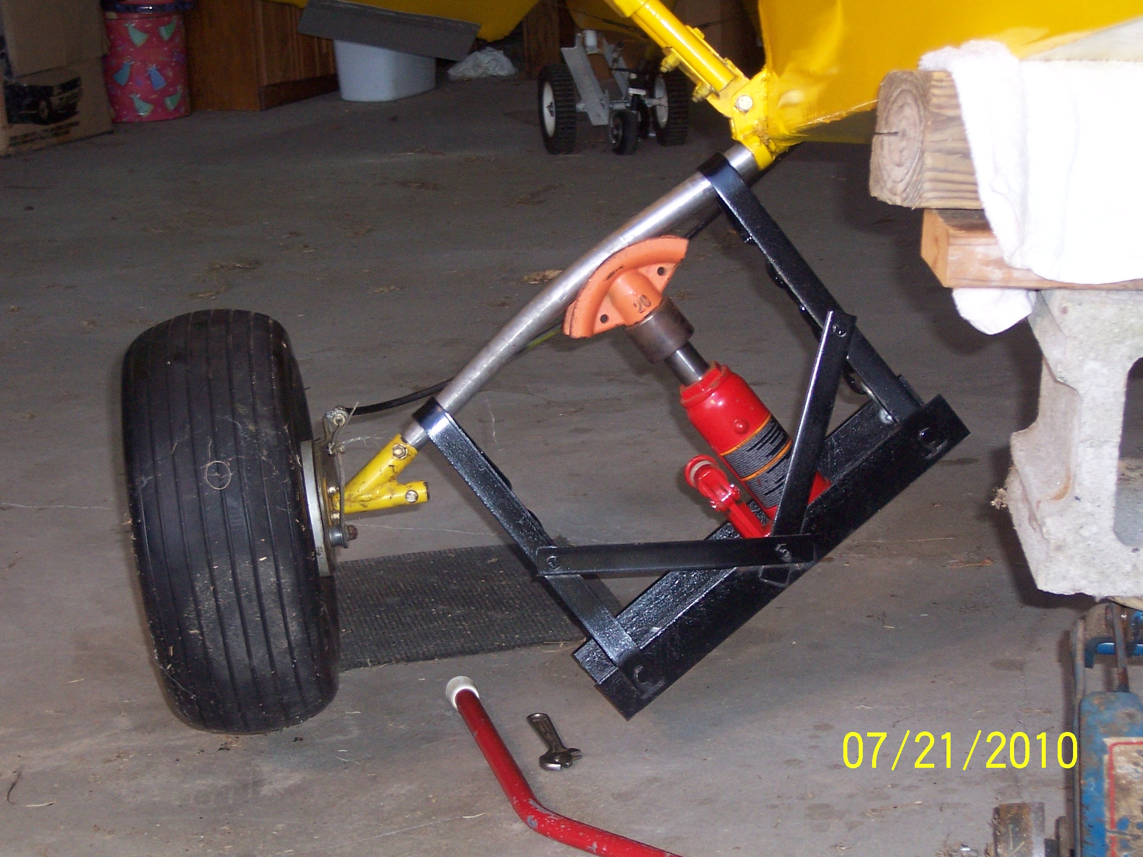

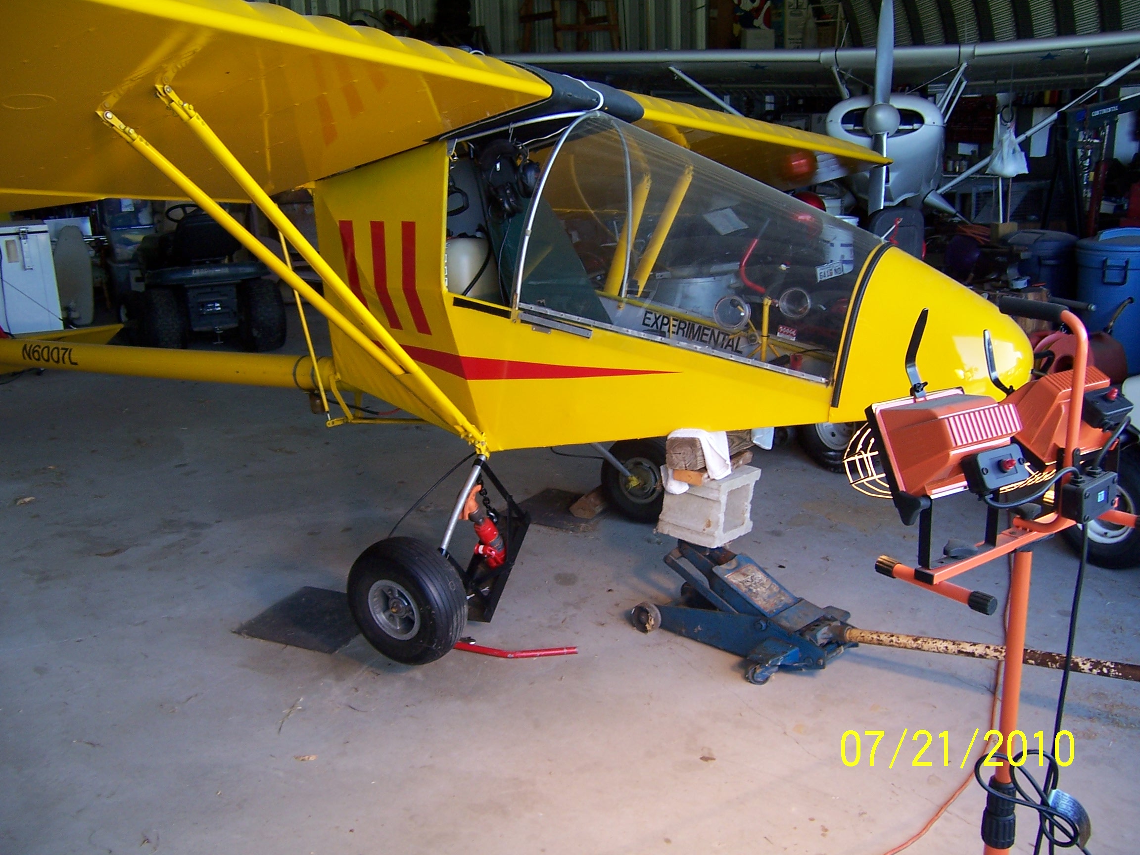

This is a portable hydraulic press that I designed to straighten the legs of my Firefly when I perform a not to good landing, does not happen too often now.
The unit can be used OFF the Firefly or attached to the leg without removing the wheel and associated parts.

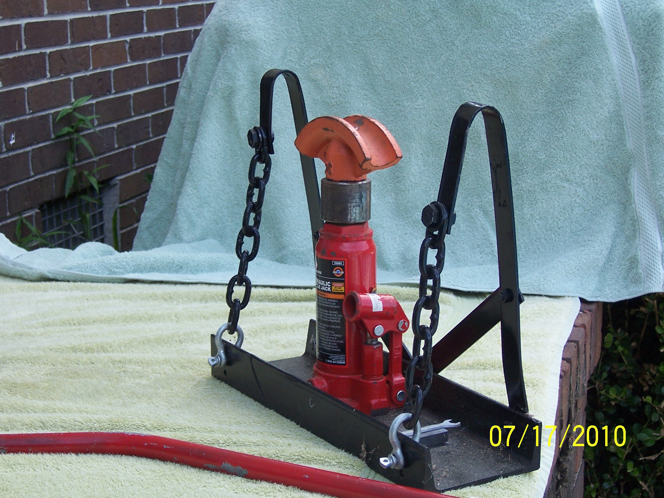

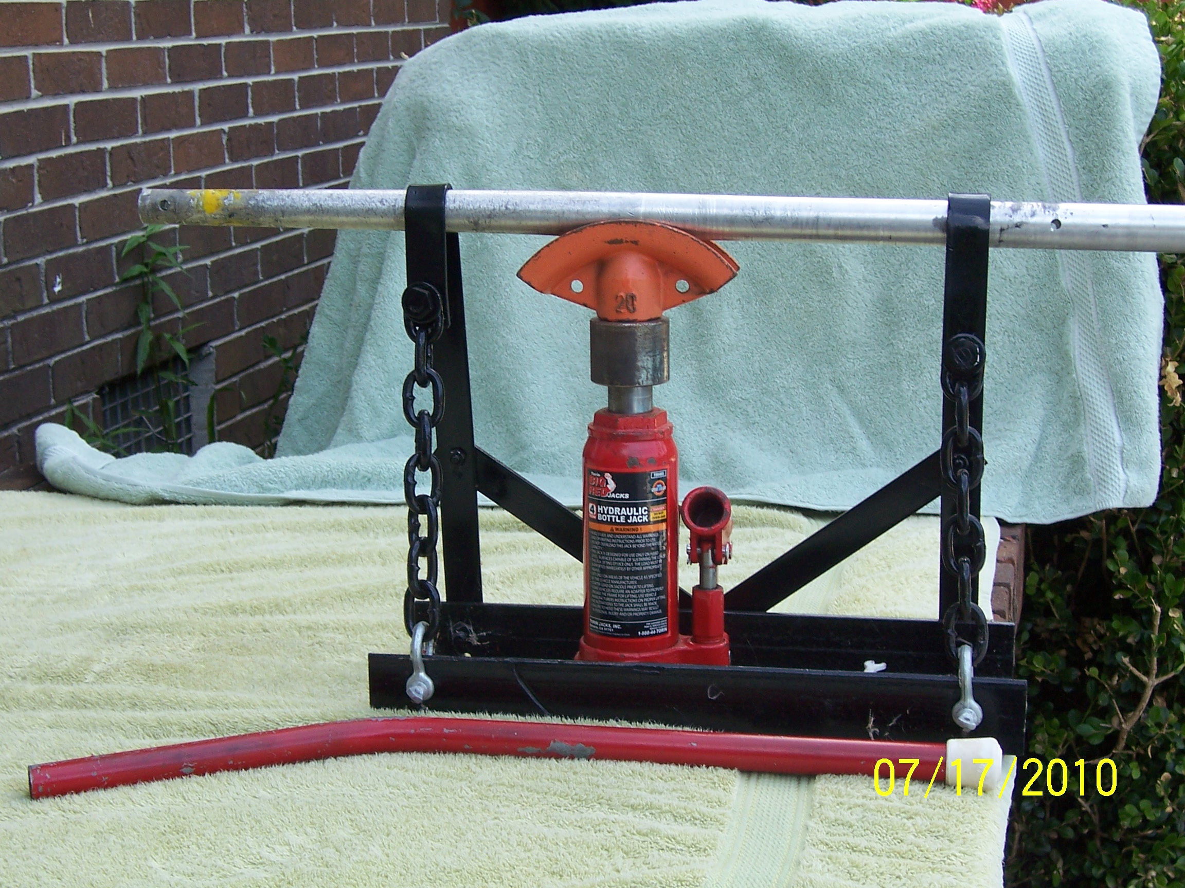

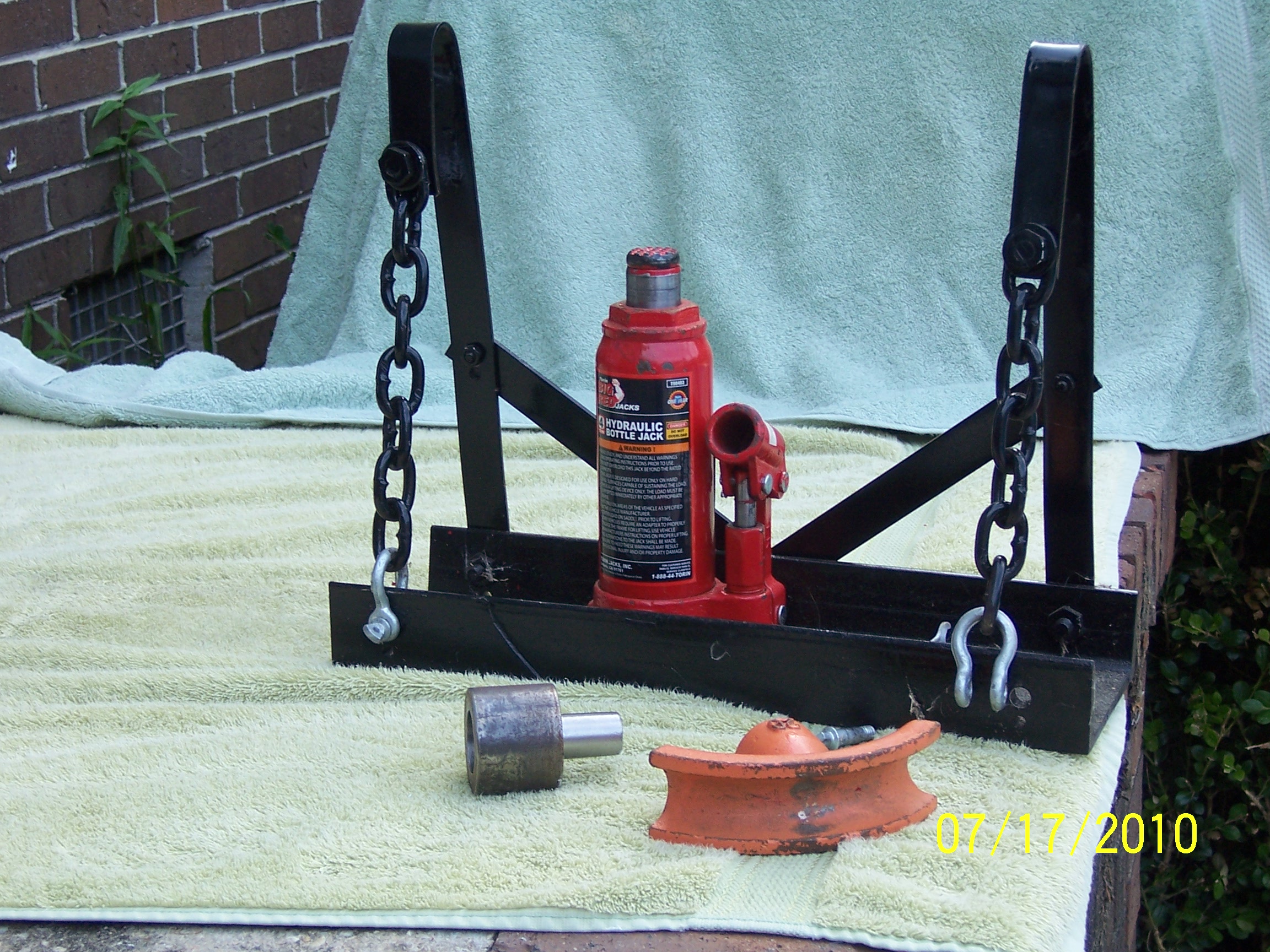

Parts used.
5 inch wide channel iron 15 inches long
4 ton hydraulic jack, (Harbor Freight)
2 I/8 x 1 inch flat iron 17 inches long
2 1/8 x 1 inch flat iron 8 inches long (brace)
Heavy duty chain (1) 7 inches, (1) 8 inches)
2 3/8 inch Chain connectors
One jack adapter Made on lathe
One 1 inch conduit bending tool head
3/8 bolts only. ¼ inch WILL brake
1 jack handle 22 inches long to fit jack (4130).
