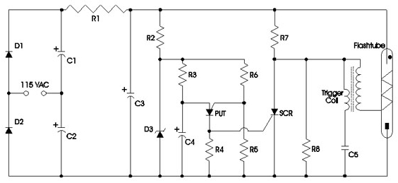

Here's an exemplar flash tube schematic:
[img]cid:.0[/img]
There are two capacitors involved with getting
a strobe to flash. One is the fat energy storage
capacitor . . . the one that gets charged to
400+ volts. (C3 in the schematic)
There's another small capacitor (C6 in this schematic)
that also charges to 440+ volts. This is the
trigger generator that gets discharged into
the secondary of a trigger transformer with
about a 1:30 step-up ratio. The resulting
10,000+ volt pulse is simply applied to a wire
that wraps around the glass envelope of the
flash-tube. ELECTROSTATIC coupling of the
trigger pulse through the glass excites the
xenon gas into conduction whereby and energy
from the fat capacitor is discharged through
the gas.
See:
http://www.repairfaq.org/REPAIR/F_strbfaq.html
What you're describing suggests that the
power supply is working and the energy storage
capacitor is charging. What you're probably
missing is the trigger stimulus.

I cannot find any C6 in the schematic. Is it that small?

C5 I think.

Did you mean C5 rather than C6?

It seems that the trigger transformer is actually embedded in the molded
silicone base of the 073-0270 flashtube. An old troubleshooting FAQ says
that a voltmeter should measure 150 to 175 volts on the trigger line out
of the power supply (scope still shows zero). The resistances that I
measure on a new flashtube seem to confirm that the transformer is in
the flashtube assembly.
It looks like the triggering SCR in the power supply is a T106C1 rated
at 300 volts. Now if I could just figure out why it has no voltage to
switch...
Yes, that's a typo. In the schematic I published,
C3 is the flash-tube energy storage capacitor and
C5 is energy source for generating a trigger spike.
Emacs!
the gas.
See:
