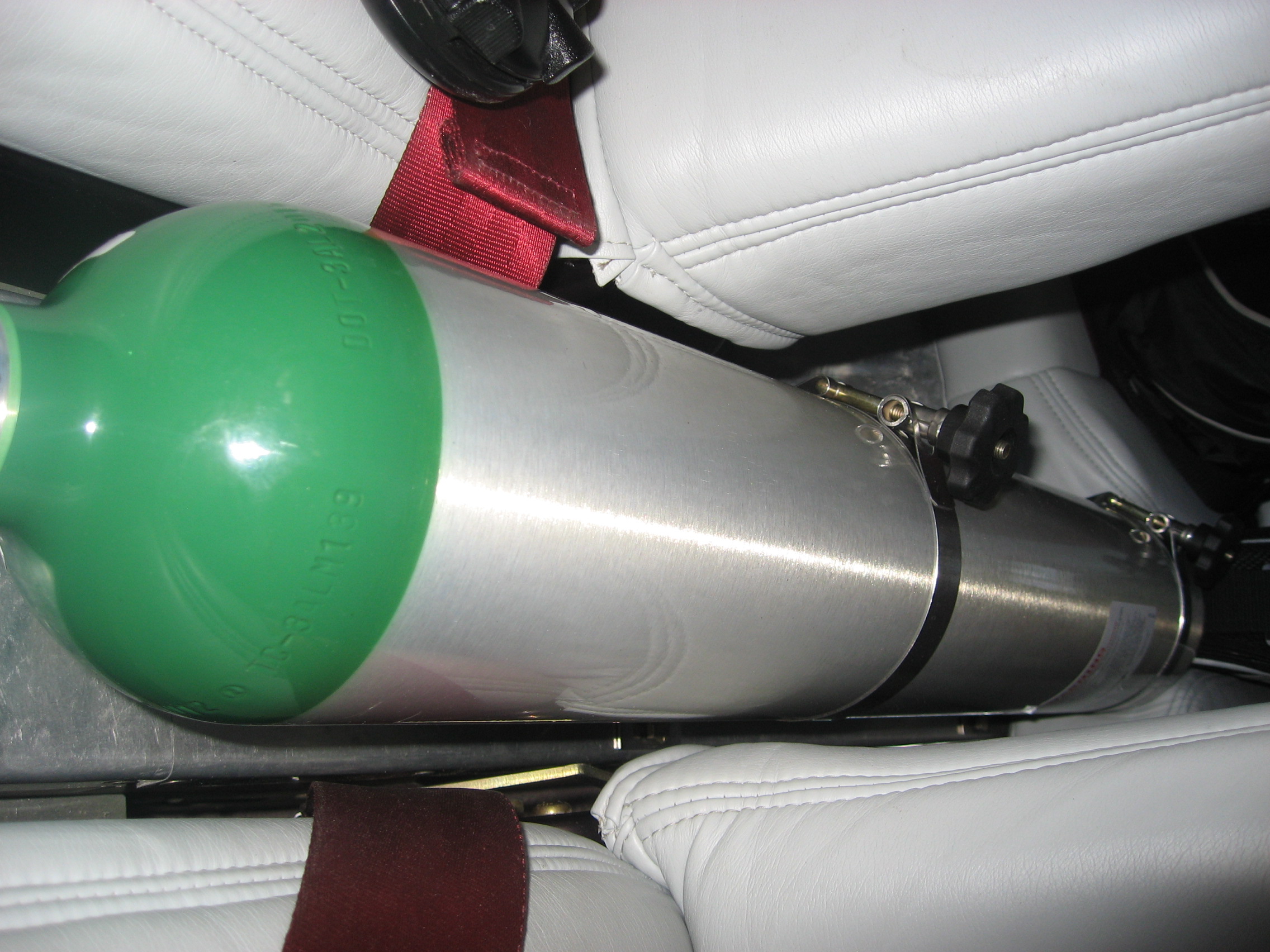

dlm46007(at)cox.net
PostPosted: Mon Aug 30, 2010 5:34 am    Post subject: O2 Systems Reply with quote
less than $200 for a medical O2 bottle and regulator and Aerox or Skyox
clamps
 Filesize:  839.88 KB
 Viewed:  8919 Time(s)

I bought a portable Aerox system and built it into the console between the seats.  An E bottle fits perfectly on the tunnel.
The main valve sticks out of the console in the front, and we made a little window so you can see the existing gauge.
The portable system has 4 quick disconnect fittings in the regulator.  I plumbed on to the front seats and one to the back seats, then split each one from there.  Aerox said splitting the flow would probably work but that they hadn't tested it--I have, and it works fine.
I bought a mixture of their fittings and quick-disconnects from McMaster for the low pressure plumbing.
The console is secured with piano hinge so it comes out pretty easily, which is how we origially filled the bottle.  But we use it so often now that I ended up putting a filler hose on it that just stows in the console.
After leaving the main valve on a couple times and wasting several fills, I put closing the valve on the checklist.
We use the Oxysaver cannulas from Aerox.  Tim, I looked at Precise Flight "Oxymizer" cannulas and they look very similar if not identical to ours.  Do you know if there's a difference?  The cannula aren't the most comfortable thing in the world, and the kids hate 'em, but they really conserve the O2.
Finally, not to start a primer war, but we use welding oxygen--as suggested by Aerox.

PostPosted: Mon Aug 30, 2010 1:23 pm    Post subject: O2 Systems Reply with quote
Tim, curious as to where you stow/place the little green demand
conserver cylinder. Do you need access to it during flight? The
picture looks like it has a dial on it.
-Sean #40303 (Fuse side skins) (and top-posting cause I like time lapse

Tim Olson
Joined: 25 Jan 2007
Posts: 2882
PostPosted: Mon Aug 30, 2010 2:12 pm    Post subject: O2 Systems Reply with quote
I have little zip bags...I got them from the Lasik place I went
to a few years ago...kind of like mini soft-side lunch boxes,
that I roll up the conserver and cannula and store in.
When we think we'll use O2, I put them by each seat.
Then in flight we open it up, plug into the bottle,
and set the demand thing by us...Andrea's and mine go
on the tunnel between us. From there, I run the cannula
hose up over the seat belt hanger and down to my head.
Keeps the hose coming at us from above. You do need
access to them in flight to set the altitude. Would be
cool to do a more permanent mount but there isn't a really
great way for that. But it works well for a portable unit.
If I were doing fixed mount, I'd just buy a Mountain High
system...if you're hard plumbing it that would be the real
nice way to go.
Tim Olson - RV-10 N104CD
