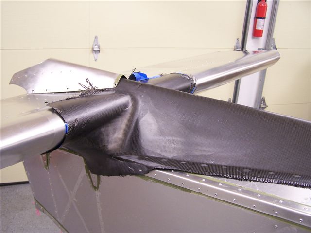

I made a fiberglass mold and built a carbon fiber fairing for my horizontal
stab (picture attached). I'm having second thoughts now because I have been
looking into the issue with galvanic corrosion between carbon fiber and
aluminum. It looks like I would have to electrically insulate the part from
the aluminum. I'm not sure how I'm going to do that. I might just make
another part out of fiberglass.
Curt

PostPosted: Wed Sep 15, 2010 9:43 am    Post subject: A lighter 701 Reply with quote
Something as simple as a layer of electrical tape would most likely suffice,
you only have the problem when moisture is present (all the time around my
house)
The resin also encapsulates the carbon fibers and isolates them from the
aluminum.Maybe a thin strip of veil mat around the perimeter where it
touches . Have used this method in Houston several times with success,
YNMV.
LO&SLO John

I was more concerned about attaching it with rivets. I doubt if I can
insulate around them. I thought about using nylon machine screws but I
would have to put in a bunch of anchor nuts.
BTW, that picture is of the first part I made. The second part looks a lot
better, without surface voids, and better penetration. It really helps to
have a second set of hands while trying to lay this stuff up.
Curt
